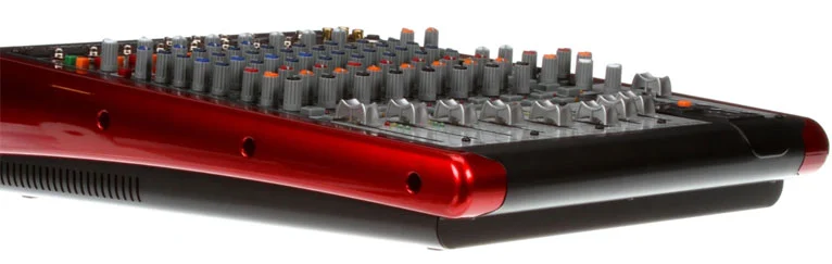

Have you considered mounting a socket in one of those side panels?
There's more likely to be space in there and it'd be really easy!

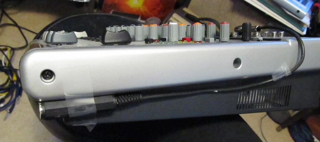

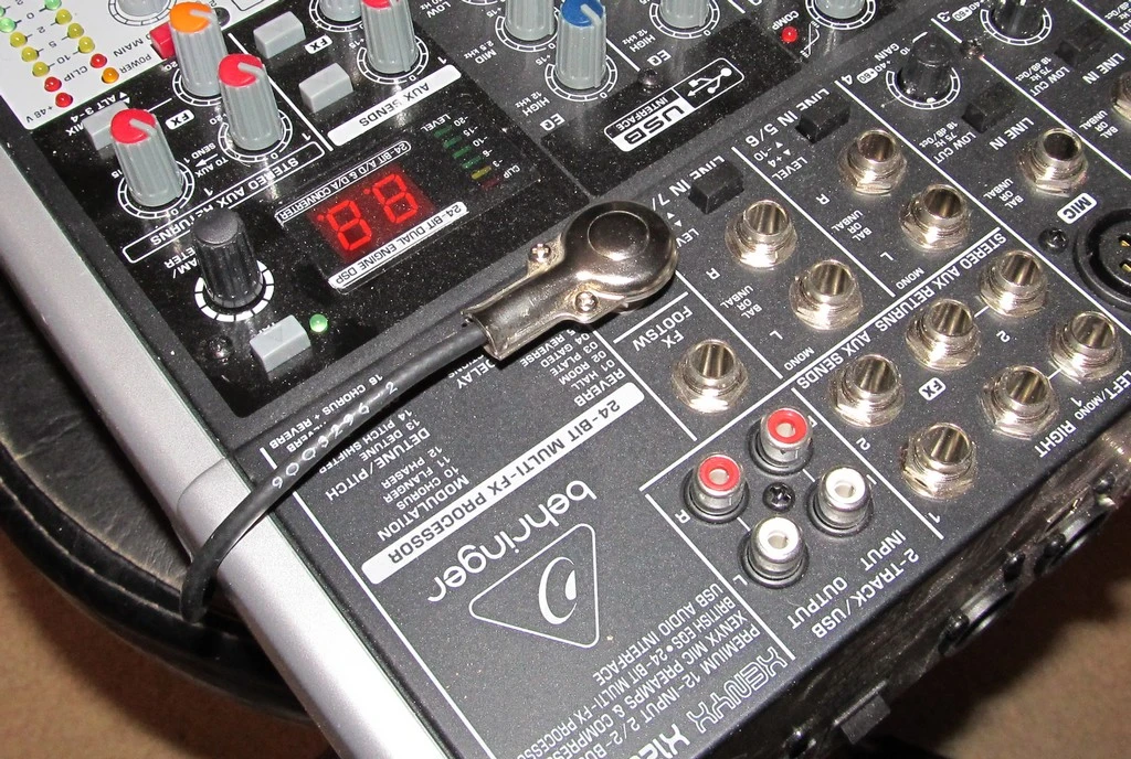

Here's mock up of what I'd likely do, cable is out of the way, and it's non-destructive. Perhaps heavy duty Velcro to mount the jack. (excuse the scotch tape :) )

Like the mock up.
Also like Steenamaroo's idea of the side panel...I suspect you're more likely to find a spot with the depth for a TRS socket there than down front where it's skinny.
...and, yeah, know what you mean about likely the headphone jack near the front. A lot of Soundcraft analogue mixers used to put it down there and it was much more convenient.
Actually, taking a second look, I bet you could get a socket on the side panel but on the front facing part. That'd be nice!
The pictured trailing lead does the job perfectly, though. That or run a cable to a patchbay or headphone amp off to the side, or something.
