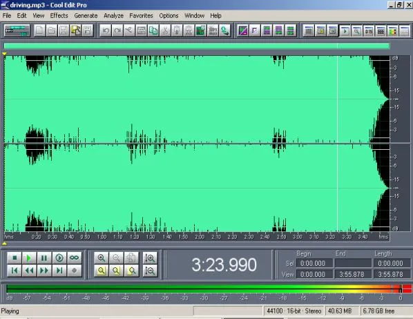

when I listened to it in Cool Edit and looked at the meter, the over indicators were on constantly.
I'm not sure how you are getting overs constantly. If you are getting overs in cool edit, the meter is calibrated wrong and you probably get overs with tracks you pull off any commercial CD.
There are no overs with this track in Wavelab or Protools. I haven't tried any other program.
Thanks for the comments. I will deess the vocal a little and maybe bring down the overheads in some spots. Also maybe automate the kick drum or guitars in some spots.
I don't know what to say. I just loaded Race For the Prize by The Flaming Lips and Young Modern Station by Silverchair. Both tunes have similar RMS and I had only one over at the end of the Silverchair tune - no big deal, just a stray transient.
I don't know how many samples it takes to trip any of these different setups. Maybe the wave file is different but here's a screenshot of the mp3:
