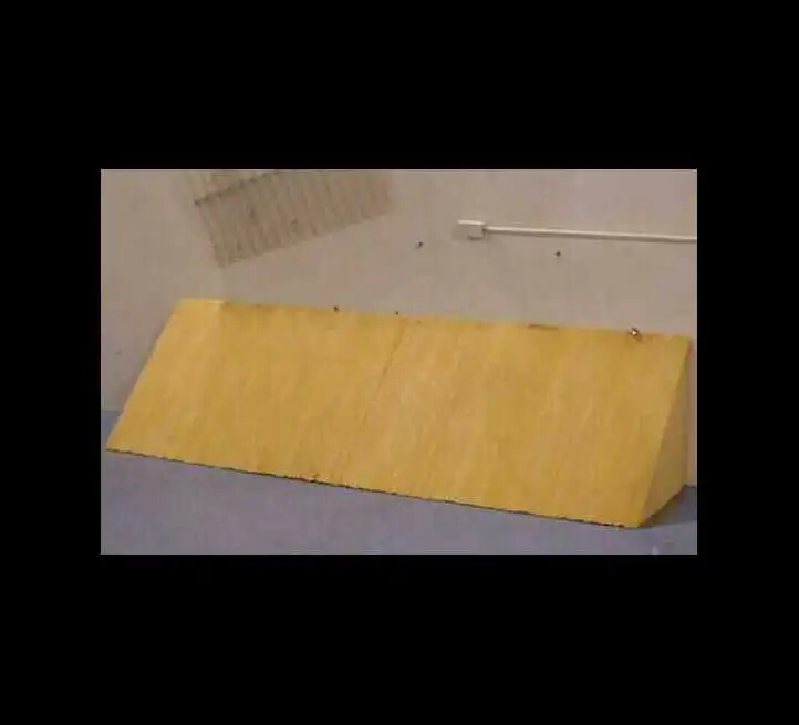

Thats because panels of rigid fiberglass come in 2 foot widths. Just lay them across the corners and Voila! :D But if you REALLY want bass traps, cut the panels in half so you have TWO 2'x2' panels. Then cut them diagonally, so you have FOUR diamond shaped pieces. Stack them in the corner. With 4" thick panels, it will take 6 panels to fill a corner. Attach some wood strips vertically to the wall at the edge of the fiberglass, and staple fabric to one side the strips. Stretch it across and staple it to the other side. These are called "Superchunks" and have been tested. Better absorption at low frequencies than just a panel laid across the corner.
Here is a pic of one in the lab for testing. As usually is done, these are laying in a floor/wall corner, which you could do as wells as wall/ceiling corners.
fitZ
Thanks for the advice and pic Rick. Much easier to do than I anticipated. I didn't realize that wall/floor traps existed. Would you have any recommendation on keeping the wedges in place at the ceiling/wall while you cover them in fabric?

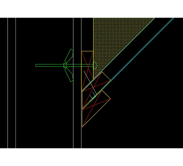

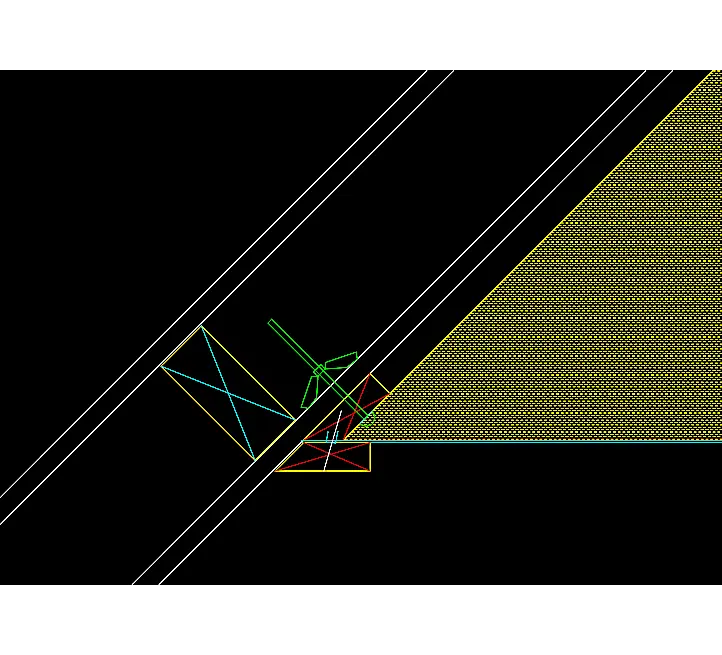

Here is a plan view detail for the vertical corners(wall/wall). However, if your wall to wall corner absorbers intersect at the ceiling absorbers, the joinery is....well lets just say have fun. :eek: :D
