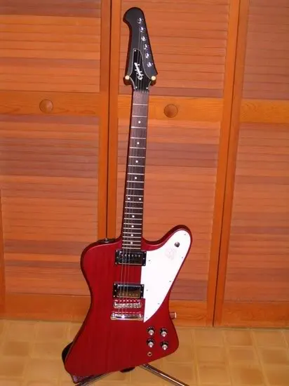

This is the 1st version and I may rework it as time goes on-but the mini's are so much brighter, much more to what I want them to sound like-it's sure worth the effort to me. Here is the original full sized pups on the Firebird.

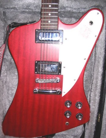

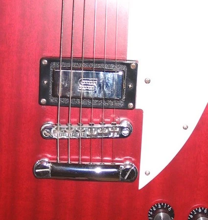

Here is the 'Bird with the mini-buckers. The 2nd picture is the bridge pickup-a hot rod Seymour Duncan.

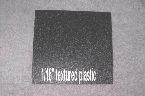

Here is some background on the conversion rings, I started with a piece of textured plastic-1/16" thick-it was thick enough to be sturdy but still easy to cut using a utility knife and a metal straight edge.

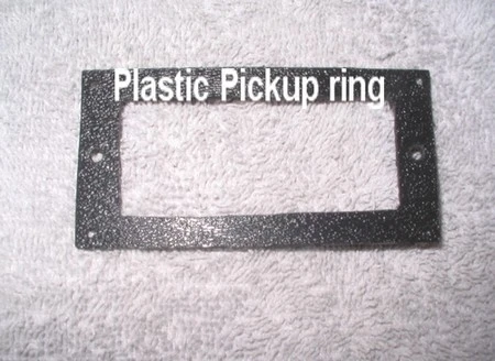

I used a hand drill to make the rounded corners then cut from hole to hole to try to keep it looking neat.

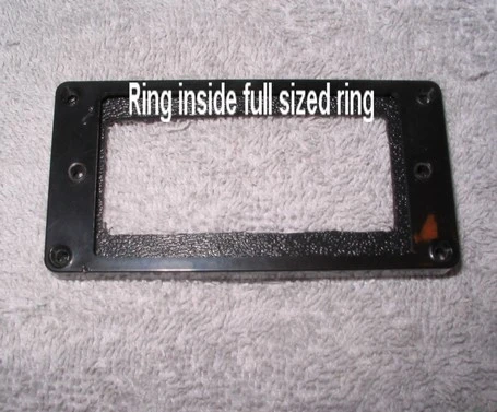

The thin ring was then placed under a standard full sized neck pickup ring. It works quite well for the neck pickup. As for the bridge pickup, I put another of the neck pickup rings under the 2 rings-the 2nd ring backwards so there would be no slant as you adjusted the bridge pickup closer to the strings.
It is still a work in progress, but it's working out fine so far. Any comments from anyone out there with other suggestions would be appreciated!
