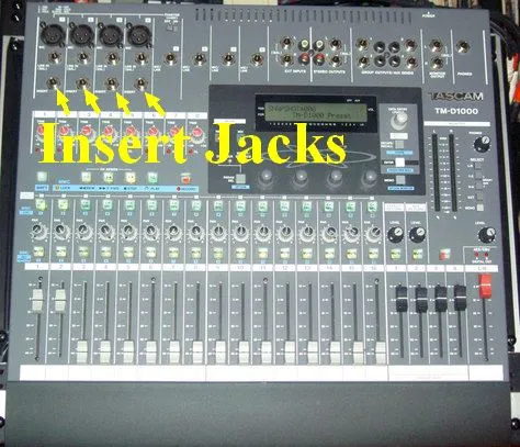

Here's the mixer I use.
Does your mixer have insert jacks?

The UB1622 has 4 inserts on the back (one for each mono channel). Use a cable like EZ_Willis showed. The TRS end goes into the insert on the mixer and the other ends go to the input and output of the compressor. The mixer uses the tip of the TRS for send and the ring for return so you only need the one connection per channel at the mixer. You can download a manual for the UB1622 at the Berhinger web site
