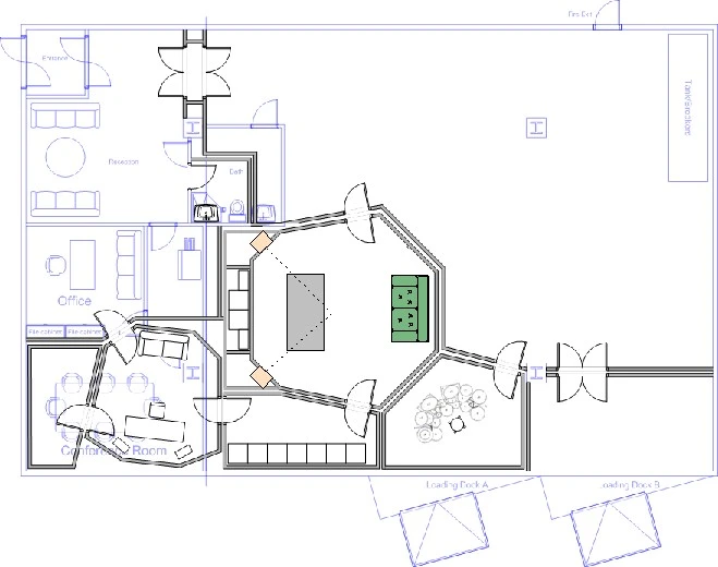

Midimonkey Design Take I
  • Thread starter Thread starter frederic
John Sayers said:
Hey frederic don't get me wrong - I'm not meaning to be critical - what you are doing is the way to go - keep trying different layouts and pick out the parts that work - I do it all the time. Design s grow - they are like a plant that starts from a seed and eventually develops into a fully grown tree.
keep at it - you'll get it eventually :):)
cheers
John
Oh, no worries mate, your comments, criticism are most welcome, as is anyone elses. I didn't take it the wrong way, no worries at all!
John Sayers said:
BTW - try reversing your control room design shape (both control rooms) - the walls should splay away from the speakers. as you've drawn them they are splaying inwards as opposed to outwards.
cheers
john
I'm going to soffit them per your and others suggestion.
Splay them away from each other, meaning rotate the control rooms approximately 180 degrees so the monitor backs are towards each other, or change the wall behind the monitors so instead of being shaped like a ball, the monitor ends are a concave?

Anyway, to my diagram, I'm still suffering with flow. And whether I should move the office/conference room upstairs onto the 2nd floor partial slab. Ugh.
Hi frederic, I know your takin a break from this. So enjoy. I was wondering about your console note. (4)O2r's. Is that what you've decided to use? Can you cascade 4 of these or are you doing something different? Your very creative at this stuff, I mean when I saw you use 6 TM-D000's, that astounded me:eek:

Now I got it. Thanks! I'm going to turn it around though, so the engineer is facing the live room, simply because I wanted glass there so everyone could see each other, but I got it now! Thanks!

I'm really not qualified for this but...
I liked the first drawing so much more than the later ones so I took a stab at it. Here, you can get to the live room and percussion room from the control room. I figured that the mics in the piano room needs less fiddling. There should of course be doors to the rooms on the outer walls, I just couldn't be bothered doing them... As for the mastering room, I haven't got a clue.
/Ola
I just realised that you don't need double walls between the server and machine rooms and that there should be a door there...
Good job Ola, I like it a lot! And you're right about a piano room. Not sure how everyone else mic's pianos but I usually use a pair of PZM mics lying on a rubber pad on the floor, facing the soundboard on the bottom.
Thank you very much!
Rick - you have some competition here heh-heh
