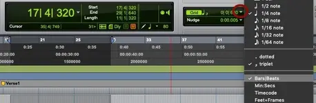

Select grid mode in the edit window top left panel.
Just below that (juuust outside your screen shot) select bars|beats, rather than mins:Secs

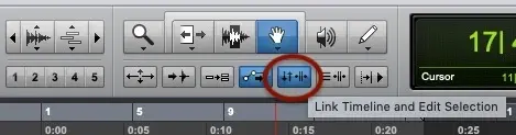

The orange marker tells me 'link timeline and edit selection' isn't enabled, so enable that.
and finally, make sure you're working in bars and beats as shown below.
If that doesn't solve the problem, please let us know. :)
