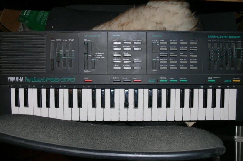

My only keyboard w/o MIDI. Wait the two middle buttons say Stop and Start ? hahah
It's intuitively obvious from his question that the keyboard is sending MIDI data to the computer, so clearly he meant that it isn't a MIDI keyboard controller. Many electronic keyboards don't have dedicated octave buttons the way MIDI keyboard controllers typically do.
