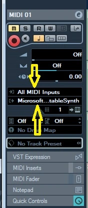

In cubase on the individual MIDI tracks your recording you can set the input and output. The default input is probably "All MIDI Inputs" or something like that. And I think the output defaults to microsoft wavetable, or possibly something that indicates it's using your soundcard. Change the output to be your keyboard. If the keyboard isn't on the list try selecting it in the MIDI set up window.
Hi Tetrafish,
Thanks for that. I've gotten that far, but in the device setup window can't activate my keyboard as a I/O out option. It lists its state as 'inactive' (but listed as 'active' for inputting of course). Can't see how to change this. There must be some button you click to make it active SOMEWHERE! Have really tried! Any help you can gave with would be great. It's proving a real headache!
On mine it shows inactive until you select it as the output on an individual track. (the bottom box on the pic).
And that's the bit I'm having trouble with. When I right click on the output on an individual track - like you show in your picture - it only lists 'VST instruments'. I'm trying to get my keyboard in that list as an option to pick for output. Any suggestions? Sorry for continually picking your brains on this - I'm stuck!
This may be a stupid question but do you have an instrument track or a MIDI track?
No questions about recording is too silly or basic for me! I have an instrument track (Project>New Track>Instrument). Should I have a MIDI track? Is that where I'm going wrong?
Yup, I think that's the problem. Create a MIDI track and then you should be able to set your MIDI ins and outs.
