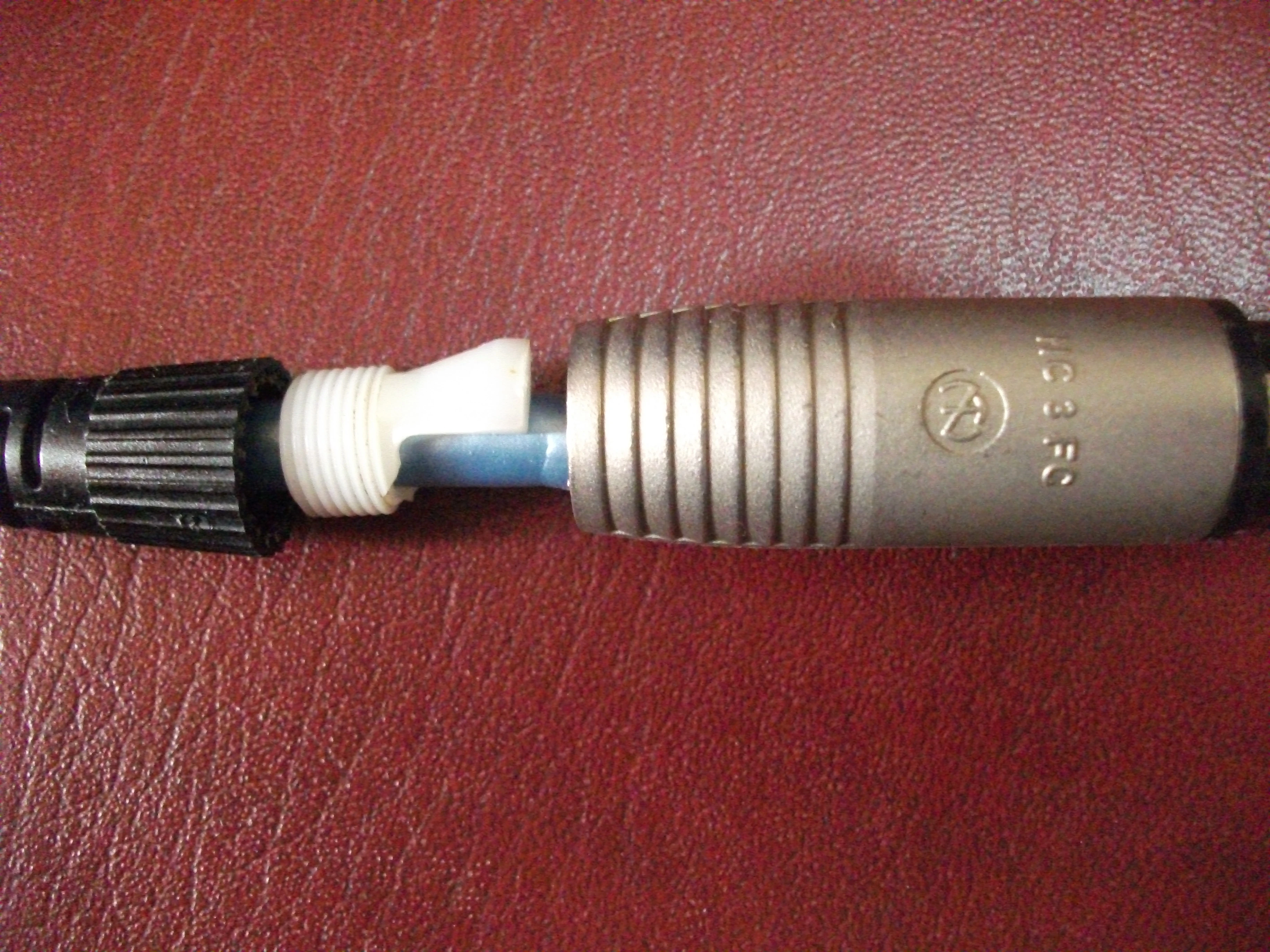

I'm not a lover of the new Neutriks with the different clamp. I'll carry on with the older design as it's stronger. The new design I have had a few issues with when stood on and the cable clamp snaps.

Dave. GRRRRRRR! Rob, not seen or heard of feeble new Nukie clamps. Do you have a picky and have you contacted them?
They'r not feeble but I had two where the outer screw on part (the bushing???) snapped off, leaving the thread inside, and the remainder floating. Not sure if the material has changed or the slightly bulbous shape is the reason - or simply just bad luck/dodgy mould? Never occurred to me to contact Neutrik - just a dodgy cable, chucked into the 'for repair' bin.

Just dug out an "old" XLR cable to looky-see and it's broke!
Now that is not a NEW plug, got to be at least 5 years old. I am going to post the picture to Neutrik because in the past they have been very grateful for information about ripoffs and copies and so I am sure they will want to know about this.
Mind you, if I have a five year old busted connector and YOU have had the experience they probably already know? Still, can't hurt eh?
Rob, you said "new" Neutrik XLRs but I got a very swift reply from Jesse at Nukes..
Thank you for your email.
I'm impressed to see an original C Series XLR considering that line of XLR was in production in the mid-late 70's and has long been discontinued.
I'm sure you can appreciate our connectors have come a long way since then with significant improvements in both our X-Series and XX-Series connectors"
Do have a "new new" one to show them? They obviously think the present stock is fine. Maybe, like me you have some "NOS" still pristine in its poly bags?
