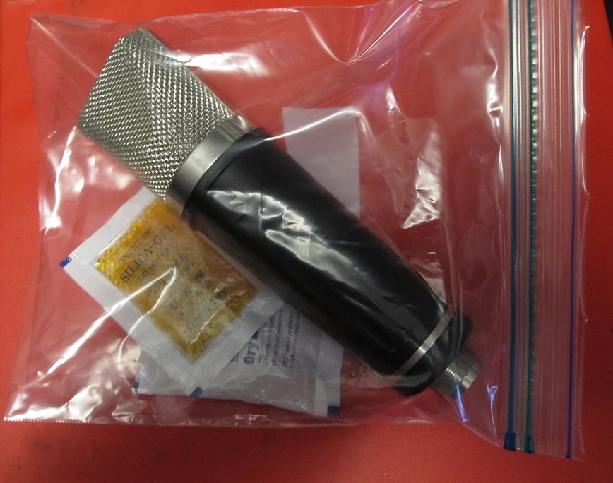

- A damp mic capsule may do just what you describe and it could come and go.
- Are you using a pop filter which will reduce the amount of moisture in your breath from getting into the mic?
- Damp/humid room?
- Try plugging the mic directly into the X1622 mixer and monitoring with the headphones connected to the mixer to eliminate the DBX286s as a potential problem.
If you think it could be dampness/moisture on the mic capsule, put the mic in a plastic ziplock bag with some desiccant packs. Dry white rice in a nylon stocking can work also in place of desiccant packs.

Unless you have good reason to use the foam/sponge 'pop filter' over the mic, I would suggest using a round mesh type pop filter instead. The room may not seem humid, but I could envision the foam shield over the mic collecting and retaining moisture from your breath. Desiccant packs and a ziplock plastic bag are cheaper than a new mic and worth a try.

After leaving the microphone daily when i didn't used it in a bag with rice and Silica Gel, it lasted for 1+ day without any signal change. Today i just opened the mic and cleaned the capsule and the board inside from dust. There was very little signs of dried humidity on the capsule surface and cleaned it with a very small brush and alcohol. Now i will leave it connected to see if it's all good after a few days/weeks. I will upgrade to a SM7B anyway, and have the 2050 as a backup or second mic. Thanks :D!
