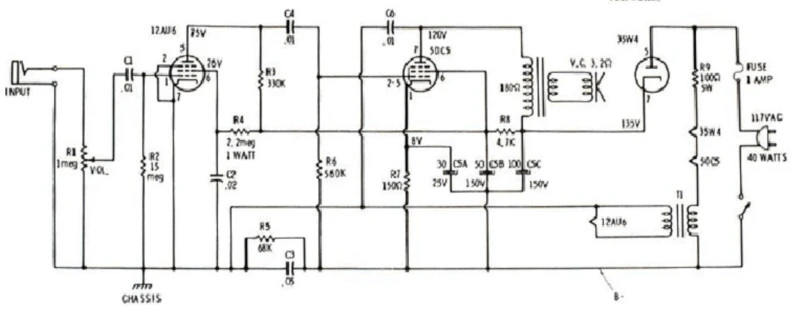

This is what I just built. It sounds pretty cool.

Thanks Mike; I've got some of those tubes, and an old tabletop radio that could donate an OT. I've never messed with anything that has the heaters in series like that. It looks cool, but I don't think I would want to touch any other gear while plugged in. :eek:
It distorts nicely if you lean into it (and with the tube rectifier, it sags a bit too which is cool). And of course, as there's no input tranny, it's not insulated from power but I wired it with a 3 prong plug and the case is grounded so I've not had any issues with shocks or hum.
