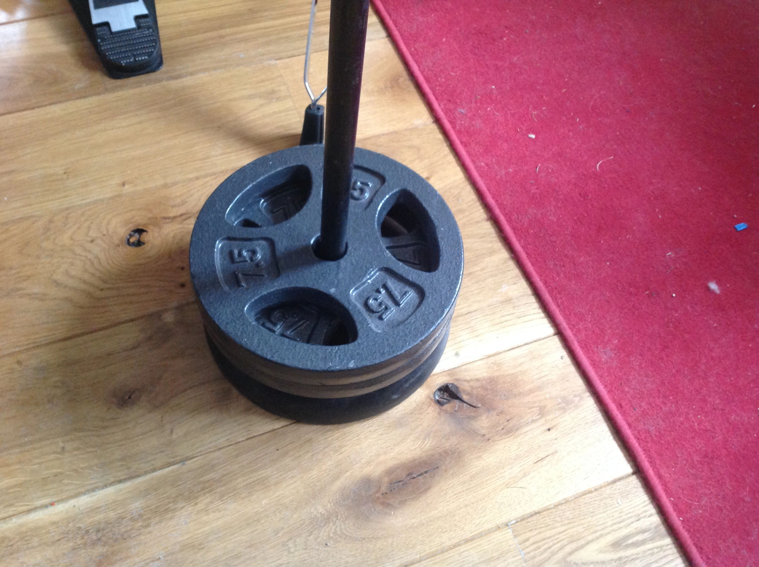

You can pay a small fortune for pro stands, you could try buying a good quality stand make sure it has a good locking mechanism on the arm or better still has the serrated type you find on cymbal stands and add weights to the base if you need.... IMG_0090.webp

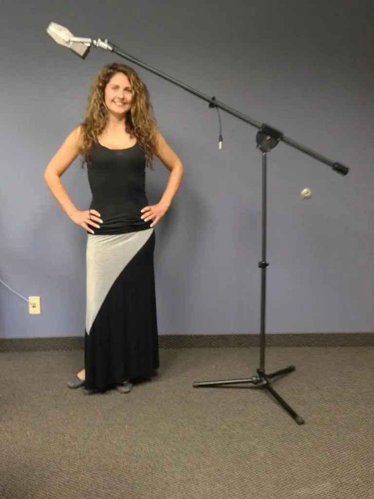

Latch Lake MicKing 1100
That is a *heavy* mic. and the lady is 5' 8" tall, to give you an idea of height.
The MicKing 1100 is a heavy, superbly engineered, stand that will take a very heavy mic. without droop - I have actually seen, at a show, a bar with about 5 heavy mics. all supported by a single stand without any droop at all.
I have one and am delighted.

And if it starts to slip you can get the lady to hold it up :thumbs up:
