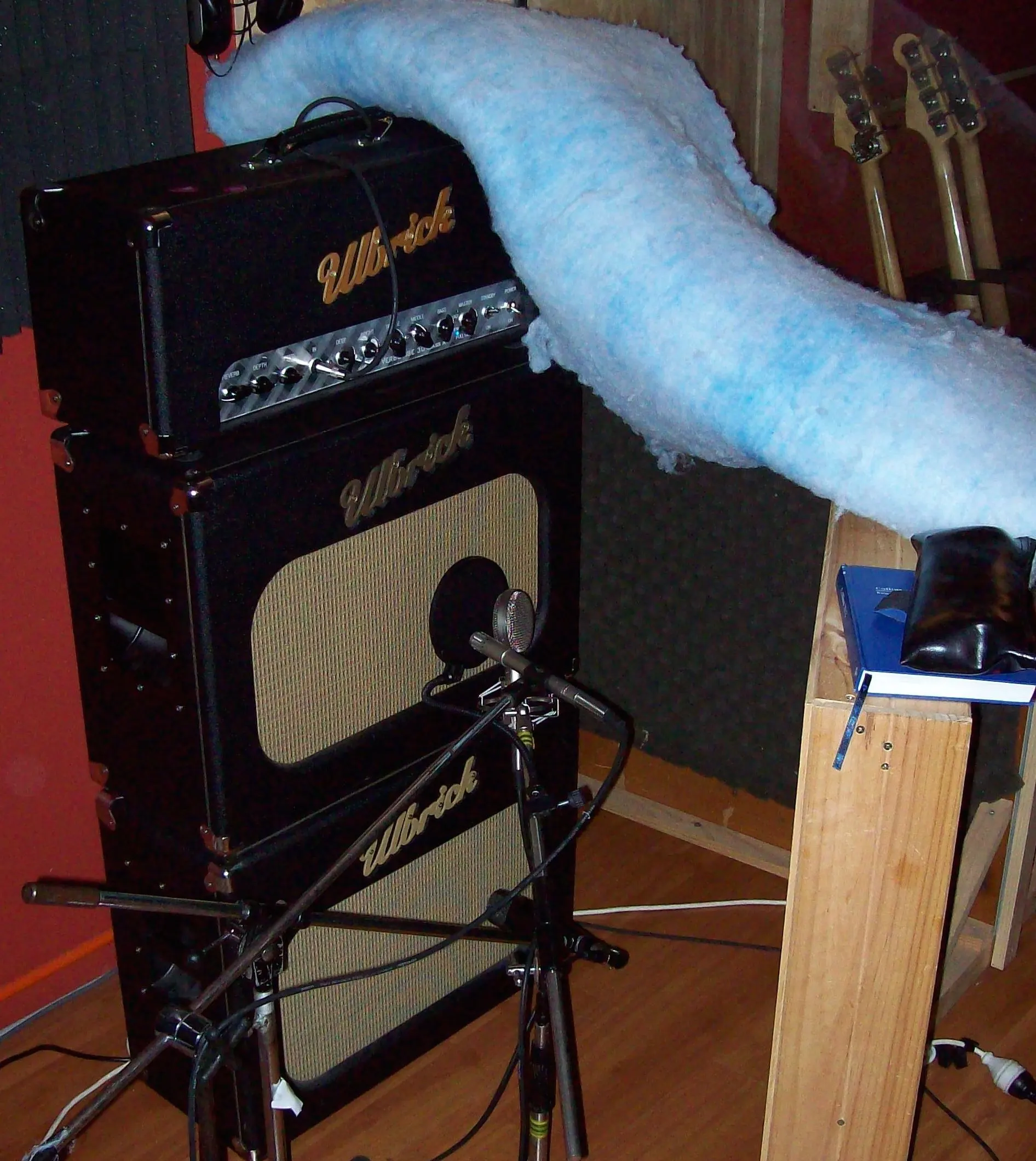

The rule of thumb is, closer to the edge more bottom, closer to the centre more tops, so I start about halfway.
This is how I miked my guitarists amp when we recorded the last album, all close kicked as we played the tracks live, guitar, bass and drums.
There is a fathead ribbon, a sennheiser ME20 omni pencil condenser and a Sennheiser 421. The 421 sometimes was swapped out to a sm57 depending on the track. All mics going to separate tracks on the recording.
Alan.
Nice rack of basses there Alan...![]()
