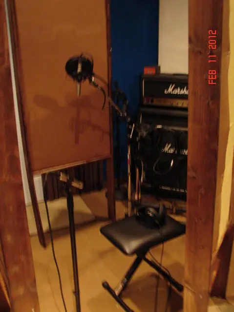

Stupid question...
What exactly do you mean when you say , over the shoulder? Is the mic up at shoulder height? Behind the shoulder? Just a figure of speech? What?
I found that a LDC positioned 2'' above the guitar pointing down at the sound hole is a very effective way to get a full guitar sound. It may not suit every style, but for finger picking or sounds mainly composed by acoustic guitar this is a good technique
Stupid question...
The boom and mic stand and mic are placed behind the player and extended over the right shoulder facing down to the bridge, just behind the soundhole. The intent (I've read) is to pick up what your ears hear with the mic, so you are placing the mic close to your ear. Here is a pic of my setup. In the photo, the mic on the boom is the over-the-shoulder mic that is over my right shoulder aiming down at the bridge. Then the other is equidistant to the soundhole but set back and aimed at the 10th fret or so.

That sounded great! You could also try this...keep the over the shoulder but instead of the tenth fret try pointing the mic just past the hole to pick up the sound of the hole and the sounds coming from the frets. Buy two get one free style lol
