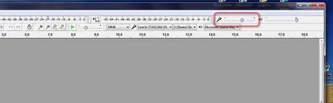

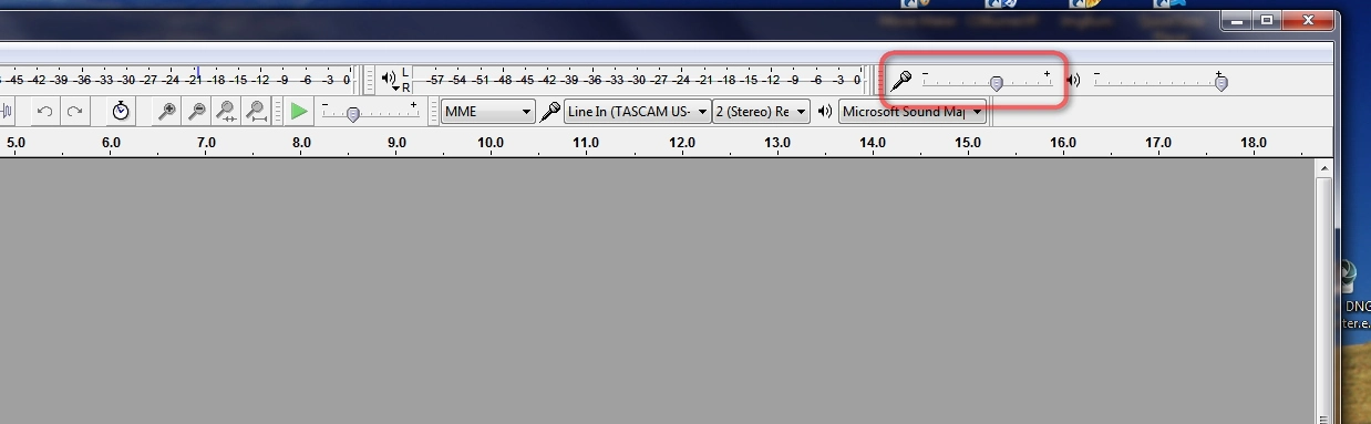

You likely have looked at this, but any possible chance the mic gain in Audacity is set low? It does affect my Tascam interface mic level. (Win7).
