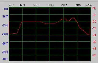

With the following EQ Curve on each track
The rhythm gtr was doubled... so that's four tracks
