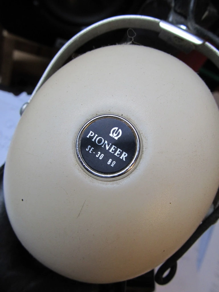

Plugging into your stereo gear in the mid 60's you might have had some low ohm cans like a pair of Pioneer SE-30's. Still have these and a pair of SE-20's also and both still function. Probably wouldn't plug them into anything relatively new, but they work and sound fine plugged into the old Sansui 800 receiver. Pioneer did make a junction box that selected either speakers or headphones for receivers/amps that may not have had headphone jacks.

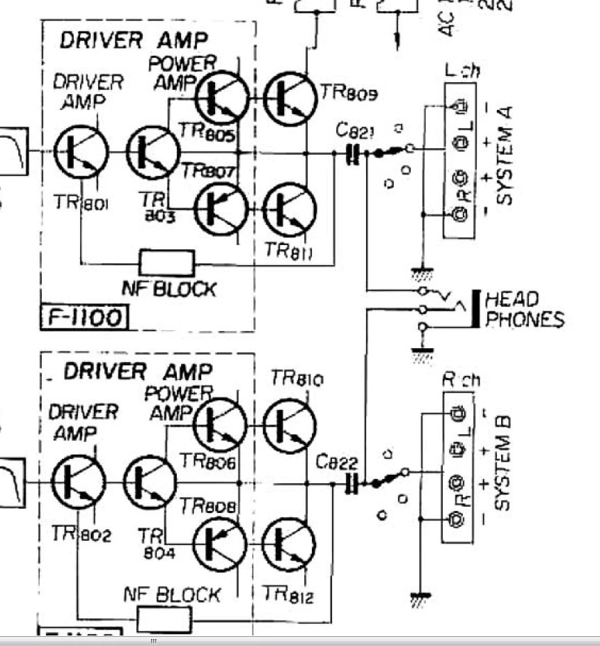

Some amps may have used resistors to attenuate, but not this old Sansui. When using headphones the speakers were set to off by way of a switch.

Yes Mark, better than a jack contact but still a switch! It would have to be pretty monumental to have zero effect on the speaker signal. My Arcam Alpha + get round the issue by having one set of switched speaker circuits for the headphone output but another set direct, i.e. not through a switch.
Also, that amp is VERY old matey! Uses AC coupling!
Yup, bought new in about 1969 in Germany. Used it up through the mid 80's. Had to replace the output transistors following a lightening hit to the house, but otherwise still works.
