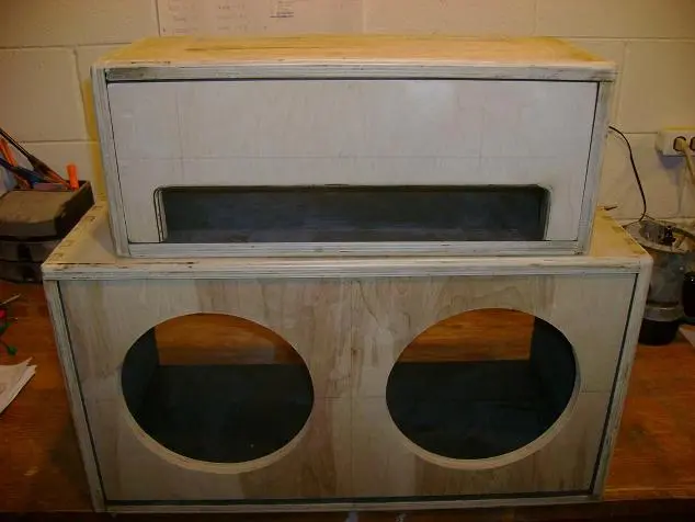

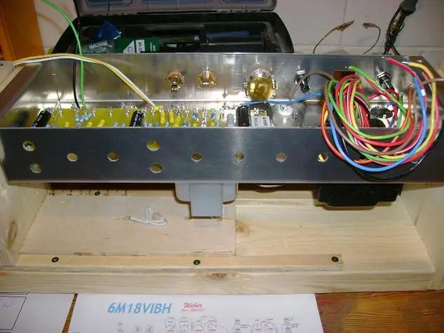

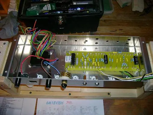

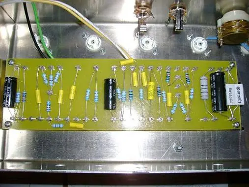

Hey y'all,
I'm over halfway done with my Marshall 18-watt clone build and thought I'd post some pictures. I ordered the kit from Weber, but I left out the tubes and the cabinet. I ordered some NOS tubes (this will be my first experience with them), and I'm building the cabinet(s) myself.
This is my first amp build. It's been a great learning experience, and there have been several "I should have done this before I did that" moments. But that just means my next one will go smoother! :)
and here are the pics...
(Forgot to post them in the original post!)

that looks like it's going to be so kickass... There's a guy in my neighborhood who builds his own amps. I hope to be doing it eventually.

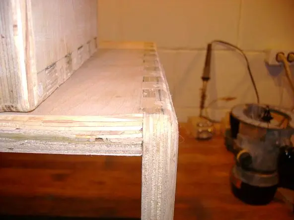

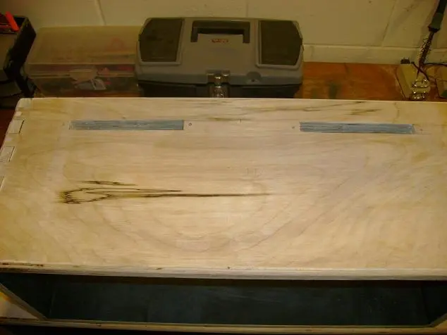

and a few more...
This has been seriously fun. Can't wait to build one for my 3-month old son! :)
