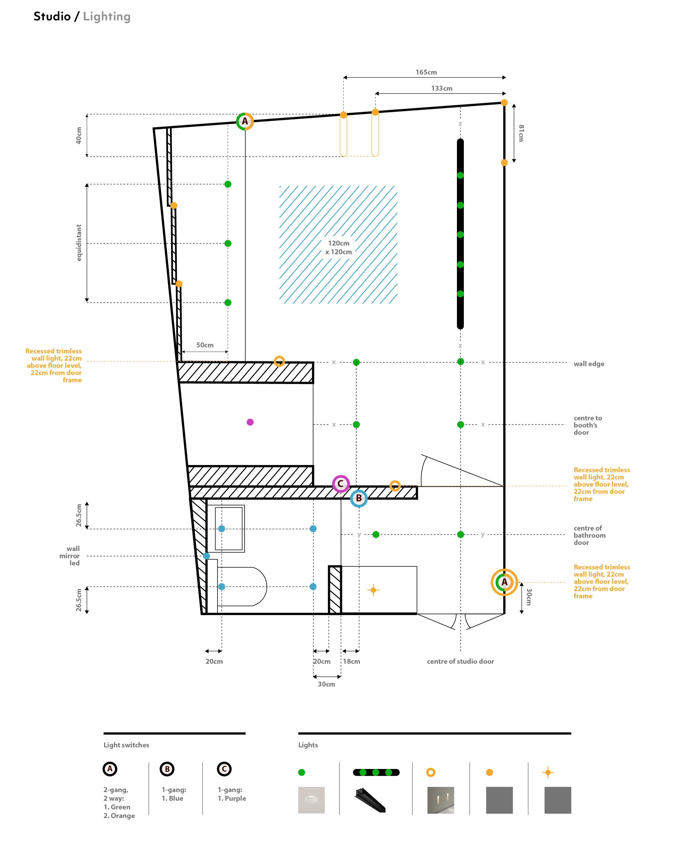

FYI behind the desk there are 3 floor to ceiling acoustic panels at a slant, as indicated in the lighting plan attached.

I'm no expert, but I think you need to hire an acoustic design specialist. Is this just a listening room? What are the overall dimensions of this room? Is that supposed to be a vocal booth (middle left with the purple dot in it)? If so, guessing by some of the other dimensions that are shown, it is probably less than an ideal size (what about ventilation to it?) I don't understand a lot of your features - why the staggered panels on the FRONT wall? A marble side wall sounds like a sure-fire way to have an unbalanced stereo image because of reflections. I don't see any good reason for the slanted left-side wall or top wall, unless that is a constraint from the rest of the design.

It's hard to comment on this without knowing what the intention of this is and where this space is in relation to any other building.
For example, I would question the necessity for having a toilet there. It takes up a lot of space that could be used more productively. Likewise for the vocal booth.
I too am puzzled by the three offset panels in the listening area. I assume the 3d representation is just that, and not how a final configuration would be. For example, the speakers don't look to be placed in a good position for listening.

The structure is already in place so there is no option re toilet or booth location.

Evidently the bathroom is right next to the studio - what's that common wall like? Very hard to keep running water (in pipes) sounds isolated, it carries through walls easily.

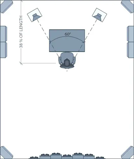

There is a lot of information available on how to set up speakers in a studio. This picture shows what is typically regarded as an optimum configuration. Not everyone is in a situation to implement this, and the result is a compromise. Speakers hard against the wall and not aligned towards the listener will not result in as effective mixing environment as a configuraiton such as shown.
