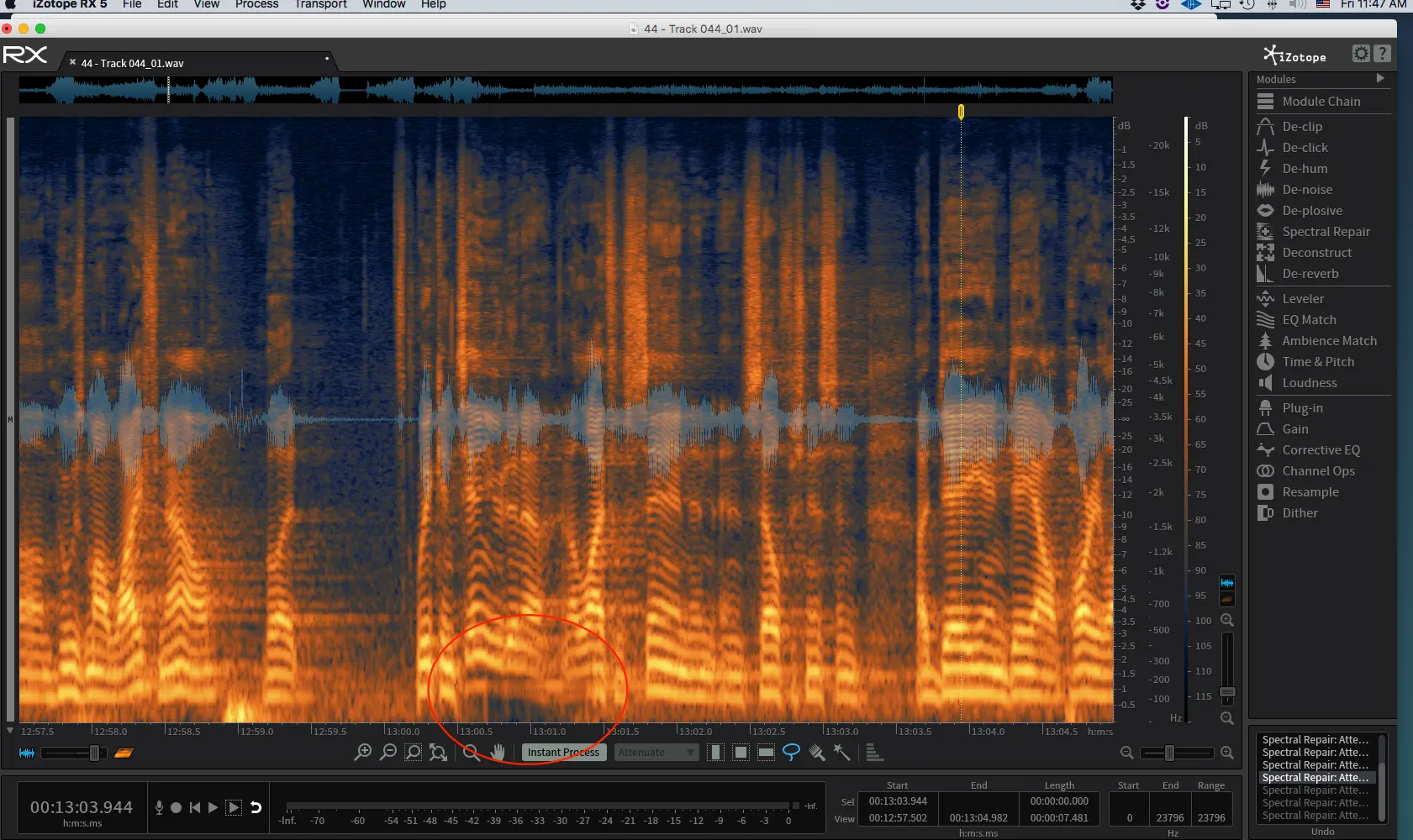

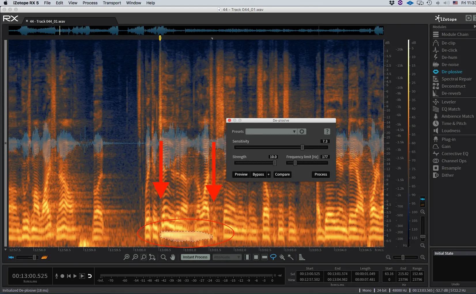

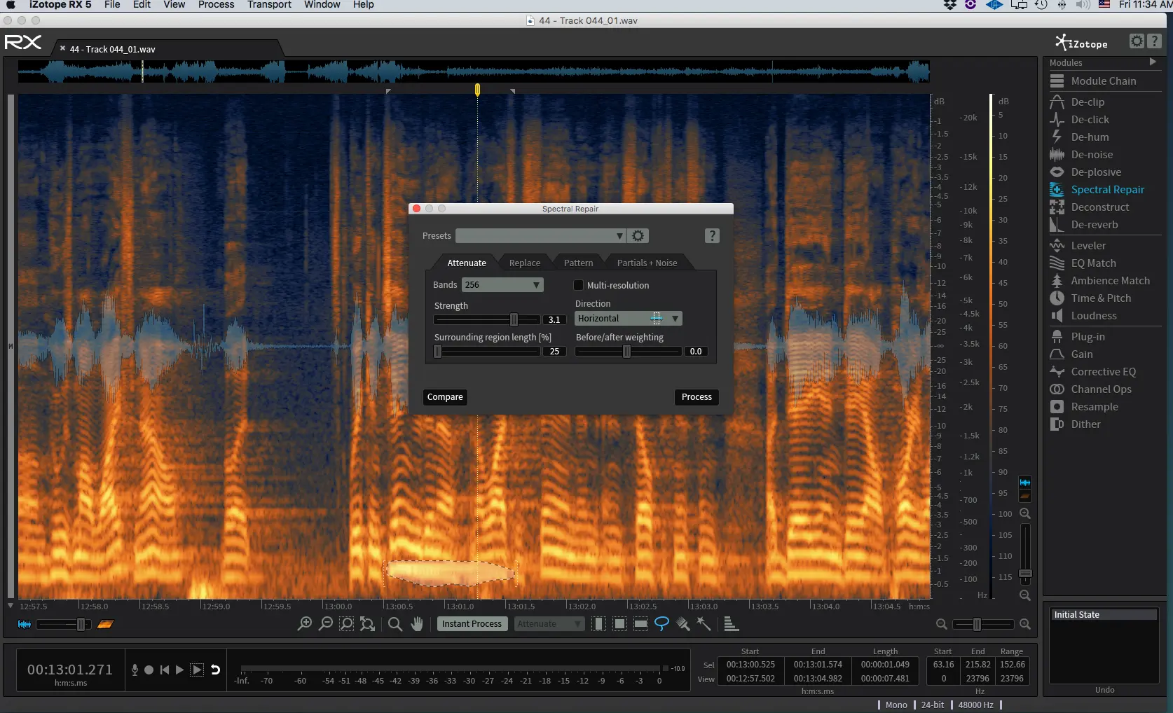

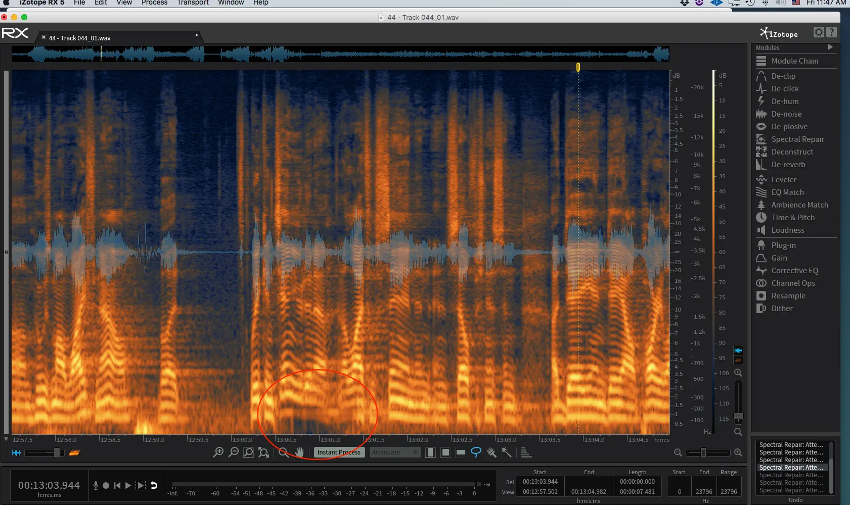

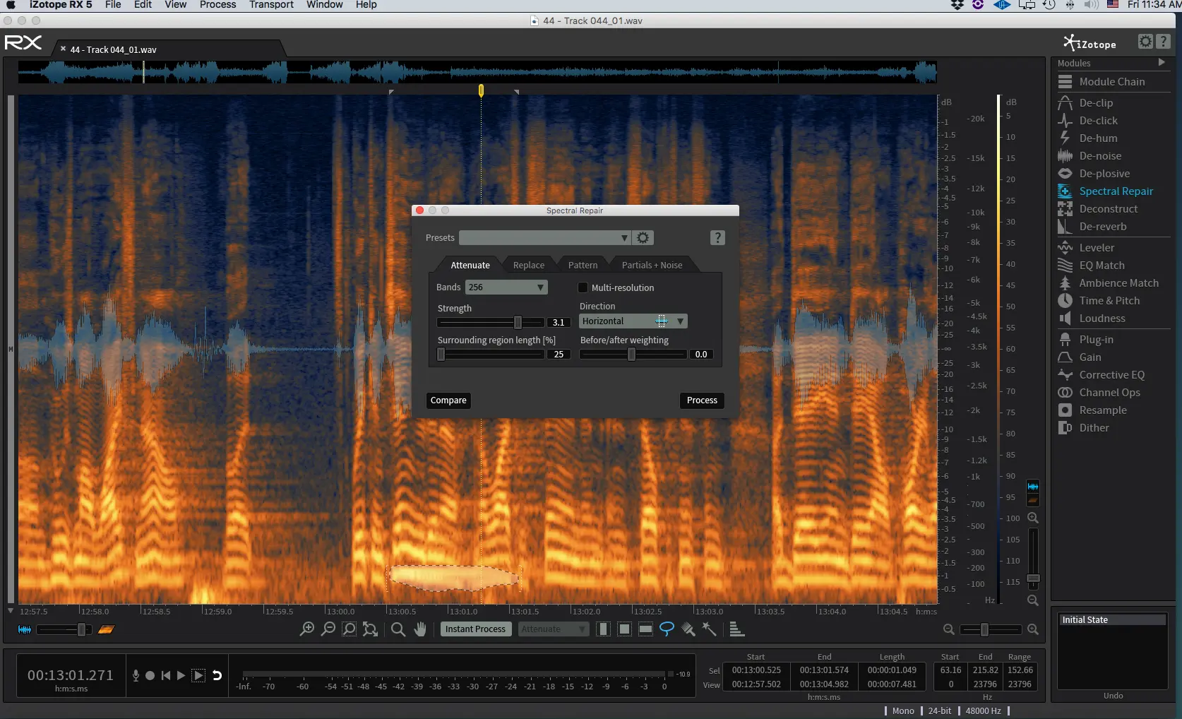

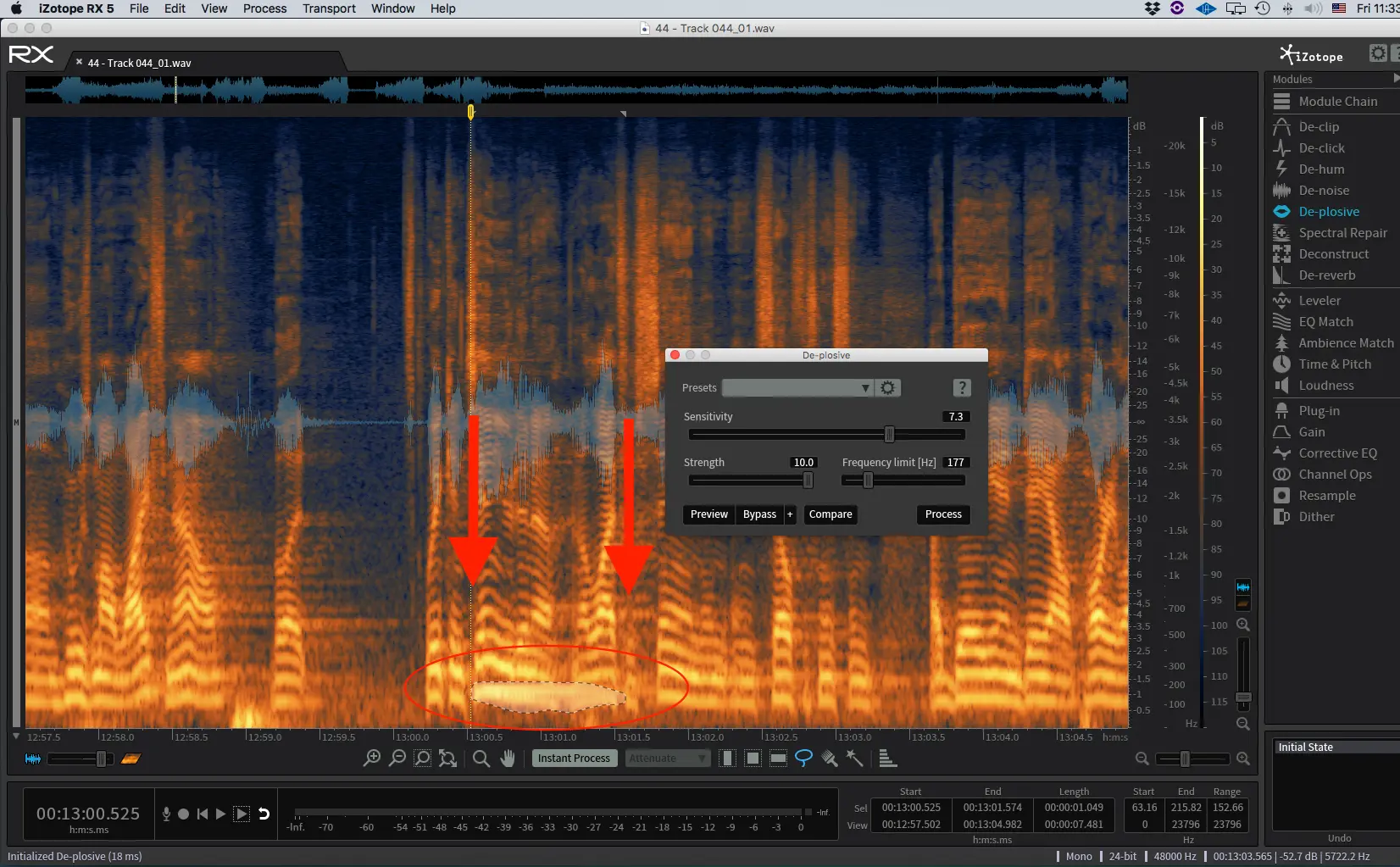

Sure. Good question. Here's my pro opinion (lol) on how this is best done manually. A spectral editor lets you attenuate certain frequency ranges and plosives will almost always occur below 400 hz. The one in this first example lets say that circled region is a plosive from a gush of wind into a lapel microphone on an outdoor bridge occurs from 13.00.5 to 13.01.6. To manually edit this out, you draw a loop around it with a lasso tool, telling the editor to only affect that particular frequency at that particular time. There's a de-plosive preset which can attenuate it, or you can use the spectral repair tool. What this does it looks at what is above, below, before, and after, and re-writes the wave based on what is surrounding it. Very similar to the 'wand tool' in photoshop. The third image is over exaggerated for illustration, but it shows what the new wave form will look like when the plosive is drowned out an re-constructed based on surrounding data.
