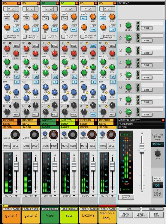

Here is the mixer FWIW.
Drums:
Low mids are at 517.6 Hz. Gain cut slightly at -2.22 db
Highs are at 3.46 Khz. Gain cut slightly at -4.76 db

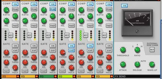

Here is the compression settings

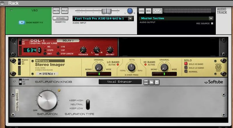

Here is the rack for the vox. The guitar outro is on the same track.
