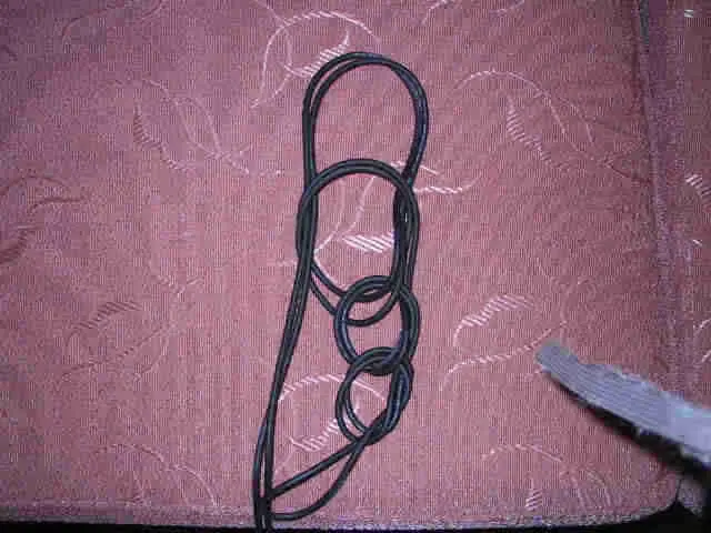

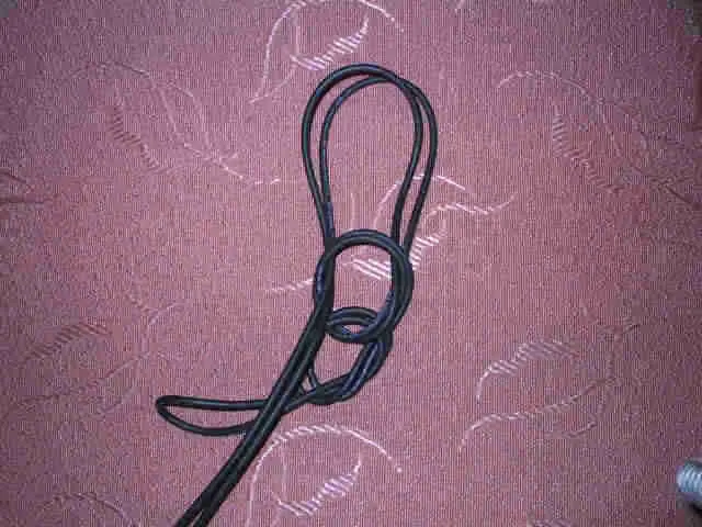

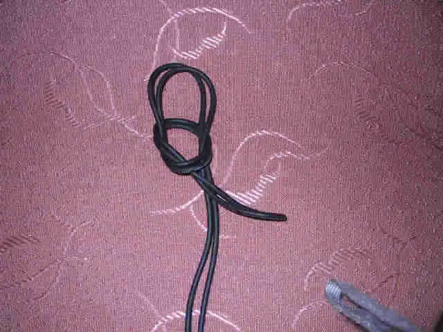

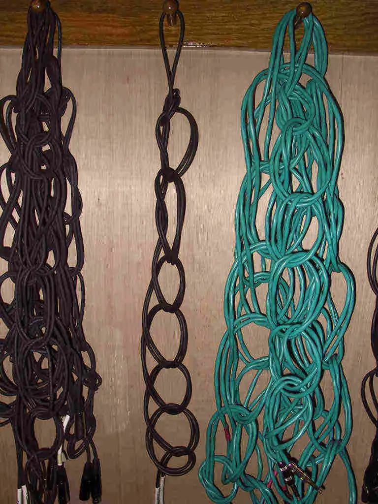

here's some pics showing how I rap my cords... at first it may seem somewhat disorganized, but there's absolutely no tangling and each cord very easily unraps. if you learn this, you'll never have tangled cables again... also it's very fast.
this is probably some sort of boyscout tie... i'm going to try to describe this
double up the cable... put the xlr ends together
where the cable bends (1/2 way point), tie a very loose knot and pull the cable back through to make a loop
now pull the the cable back through that loop making another loop... continue until the cable the XLR ends are reached... you'll have a bunch of loops
tuck the XLR into one of the loops... note how you do this... you'll need to untuck it
pull the ends and the cable will tighten up
now to unwind take the XLR ends, untuck from before, now pull the XLR ends and the cable unraps automatically. if the cable does not unwind just by pulling it, then you've untucked it incorrectly.
the great thing about this is that you can put these in a box or bin and they never tangle or you can hang them on a wall. no tangle, they unwind very easily, and no velcro to keep track of.
this may take just a bit of practice, but once you get it, you'll never use any thing else.
if I haven't sufficiently described this, let me know and I'll try again.
I used this while playing in Bands...

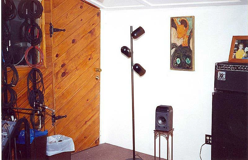

Here's what I use.

Oh my....
Sonixx thats either genious or insanity or both. :eek:
But i tried it and it does work pretty well.
Unfortunatley i dont have the hanger real estate to hand em like that in my studio.
Buti thank you for the tip, because i am going to use it for My live sound end of buisness! Man those cables coming out of that big rubbermaid can be like spagghetti hell sometimes!
Thanx. :D

You're welcome...
This method is a godsend for managing cords when playing out. I used this method for years and it reduced setup and breakdown time significantly. I use it for all of my cords, hanging on the wall or not.
Also, I always loop them so the cable ends unrap first. One cool thing is that for long cables, sometimes you don't have to unloop the whole cable, just what you need.

Sonixx,
I got the first loop based one of the pictures, but I'm unsure how to wrap the rest. Can you be a little more descriptive, such as what part of the cable to wrap through which loop as you proceed through the process? Thanks, it sounds like a good idea.

Sure thing...
Don't double the cable up for this example...
Take a Cable End and tie a very loose square knot...
Pull enough of the rest of the cable through the square knot to make another loop... refer to pics in previous post...
This will make another large loop...
Do this over and over until the cable is used up...
When you don't have enough cable to make another loop, tuck the end into one of the loops...
For cables longer than ten feet, I may double up the cable and start with the non-connector end. This way you unrap starting with the connectors.
Once you've got the hang of it, and you've done this a bit, i think you'll agree it's better than the old circular methods. This method absolutely never tangles and you don't have to try to figure out which end was wrapped last as with circular (old way).
