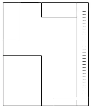

Hey I attached a simple drawing of my room, I do have a more detailed one, but I think that's only more hasle now. The glass wall is a side wall from the position where my monitors will be: against the wall with the door in it. I included a picture of lamellen: they are the yellow/green thingies in the windows. This is not my room, just some picture from the internet. The golden section is sort of explained already. The ratio is actually 1:1,6:2,6. There is about 15 cm between the lamellen and the curtains. I already made plans for where to put bass traps based on replies from other forum members. I now need absorption on that particular wall, any suggestion for particular material?

I forgot some things, and my post just got deleted. The room is about 12 or 13 square meter. The lamellen are near the glass, but it totally depends on how you turn them. The golden section is something to with math, ancient greek people used to build acoustically perfect rooms or so. It has various other uses. And acoustics is not the main one.
Just what type of material should I just for constructing absorption panels? Again rigid fiberglass or something else?
