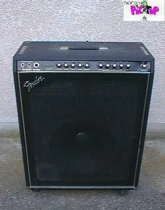

My neighbor just gave me a Fender Studio Bass but the speaker is blown. I was planning on using it for a guitar but I don't know if I want to refurb it.

Is that tube or solid state? Just thinking, because the first bass amps Leo Fender made were open back with a 15" but he found the sound lacked definition so he put in 4 x 10" and they became legend. Just a thought.
Yeah, unless it's got some glass in the back, it might not sound all that great.
But, it's certainly worth a try. If all that is wrong with it is the speaker, hook it up to another cab or something and check it out. It might sound really cool.
