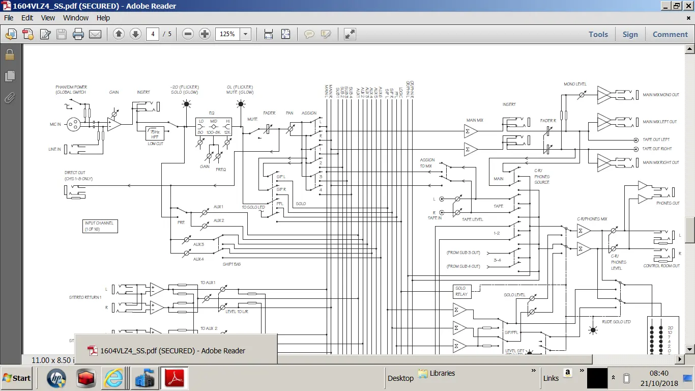

Did I read that you are recording from the inserts?
Well the signal would start from the line in then I’d be using the inserts to send the signal back and forth from the recorder. Would this mean that the signal couldn’t be EQd before the recording but only post? That would be unfortunate but not a major set back.
Err? Yes!(no?) The insert is, AFAICT pre HPFilter and definitely pre EQ. You could take a record feed from the Direct Out but that is also post channel fader and I could see that being a nuisance to a disaster! It is possible that there are jumpers in the mixer to change these routings but I doubt it.
Have you got the user manual to hand? If not DO download it and study pp 4-5, the block signal diagram. This is the sort of stuff you really, really need to know.
BTW I have not done any "proper" tape recording for a long time but if you DO go for "EQ on the way in" be careful. There is already a bit of HF boost in the (NAB probably) EQ and hitting the tape even harder can get nasty.

? Not on the diagram I found friend. Be rather good if it was.
Hm, I was going from memory but it looks like my memory is incorrect. Maybe it's my GB2R that's wired that way.
The Mackie has direct outputs on the first eight channels. The OP could operate it like an 8-track split console setup until he needed more tracks, then switch to the inserts.
