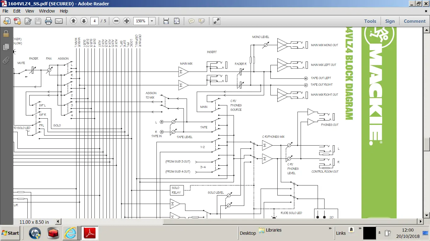

I think I owe the OP an apology!
See attached, the headphone feed shares control with the Control Room Mon outs and it is these that would logically feed the monitors.
This still does not explain the lack of control/headroom of the speakers but yes, there is no independent level control of cans and CR output. The easiest solution I can see is a "kill" switch in the monitor feeds, 4 pole flipper in a tin, bit more DIY! Simples!
