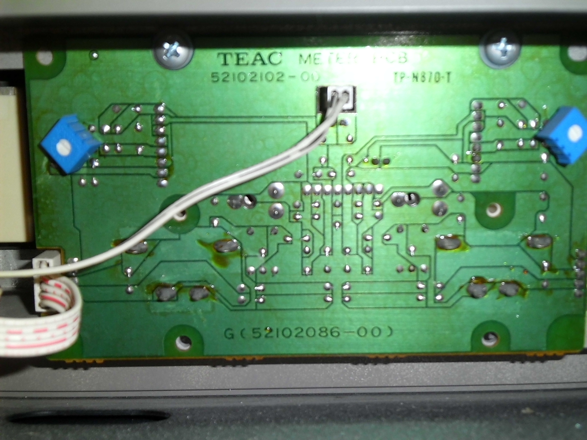

Also, the manual mentions adjusting the semi-fixed resistors on the VU PCB. How would this be done, if found to be necessary?

Regarding your question of adjusting the "semi-fixed" resistors for the VU meters, boy oh boy I have no idea if they mean jumper adjustments or actually changing out resistors or what. If you have scans of your manual with the schematics, board layouts and parts lists I can probably answer that more difinitively for you, bout outside of that I'm not certain.

Re; the VU meter adjustments they all have adjustments. see photo.
