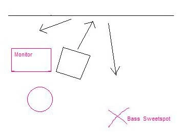

On a pure physics level I agree with the non-directional statement however when the low frequncies are being ported out of of a 2 inch hole on the back of a monitor, it is very directional for a short time. Here is a diagram so you know. The port on these monitors is not out the front like other brands.
Regarding traps, in this case, I don't want one. I need to hear the bounce off the wall.
Here is a diagram so you know what's going on here.
Nice site though. Thanks for the link.

Another point, I don't think its phase cancellation because when I hit the mono switch the lo end does not increase. I think it's just that there is not much lo end being projected out of these 5 inch speaker boxes and the little that is, is going out the back at such a low volume level that to hear it you need move around.
Not an issue with more expensive monitors.
MM
Actually the smaller the hole the less directional it is. Getting into the physics of it, if the wavelength is bigger than the hole, then it will spread out in all directions after it goes through the hole. The speaker was designed so that at whatever frequency the hole is tuned to, bends around the speaker and is in phase with what is comming out from the front.
mate - it's the bounce off the wall that is causing the cancelation - unfortunately you can't describe the pressure gradient of low frequencies by lines with arrow heads. ;)

John, I appreciate your technical knowledge but that is not the case here. I never indicated I had phase cancellation, you did.
These are 5 inch speakers guys, not a lot of bass there in the first place.
