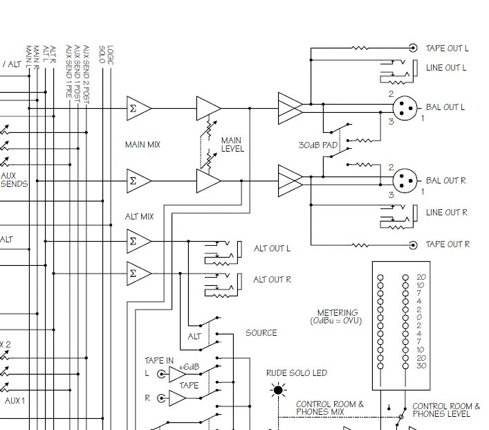

Can you use the 'Main' outs to the Focusrite and switch all the synths you don't want onto the 3/4 Aux bus and leave the one you do want on the Main bus. The main mix control out might be able to push out a bit more in level(?) Use balanced cables on the main outs to the Focusrite as those will up the level versus using TS type cables. You didn't mention which Mackie mixer you had, so I don't know if the 1/4" main outs are balanced or not or if the mixer has XLR main outs which would be balanced. If only the XLR outs are balanced use an XLR to 1/4" TRS cables to the Focusrite.
it's a 1202 VLZ3 so the main outs and Alt 3/4's are balanced. I can get plenty of signal to the audio interface with either output, I am concerned here with weak signals coming into the mixer which might introduce noise.
oops I think I needed to quote to respond directly to you. So...
Alt 3/4 outs are kinda, sorta balanced (electronically impedance balanced with a resistor), but not true balanced like the XLR outs which can give 6dB more level that the 1/4" outs.

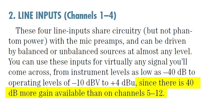

I've got a Behringer X1204 which is kind of close to the Mackie. Plugged in a Yamaha keyboard set at full volume into the stereo ins on the Behry and got similar levels that articranger is describing. The normal line inputs had plenty of gain available and I could easily max out the VU meters. From the Mackie user manual there is a note that the 5-12 stereo ins are a wee bit lower in gain than the line counterparts, like 40dB which likely would account for the levels he's getting. On the Behry I was able to get the level up to a reasonable level by maxing the channel fader level.
The Mackie manual shows the stereo ins have a range of -10dBv to +4bBu.
