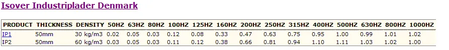

Depending on other factors, the type of material, density, etc, the absorption can still be very good below this limit. It doesn't simply cut off at this frequency, but tails of. For instance, 4" OC703 even increases absorption at 500Hz, and 250Hz(1.24) than it does at 1kHz(1.08), but then tails off a bit at 125Hz(0.84). This can be caused by a few things, i don't know much about them, but there might be a dip at certain frequencies that the coefficients test picked up, the material and density might be better at absorbing lower frequencies, etc.
I think this can be shown better(is more accurate) at lower frequencies, although coefficients usually don't show these. I will attach one of the coefficients(2" materials) which show it tailing at LF. It's actually below 1/4 of the "theoretical" limit before it tails off below 1.00. This really all depends on the material though.
Maybe it isn't a limit, but a peak... hmm. That might be it... :o

I see, so it might be 1/3 as effective at 160 Hz for example. That's fine, I'll study up on this. Thanks for your help.
