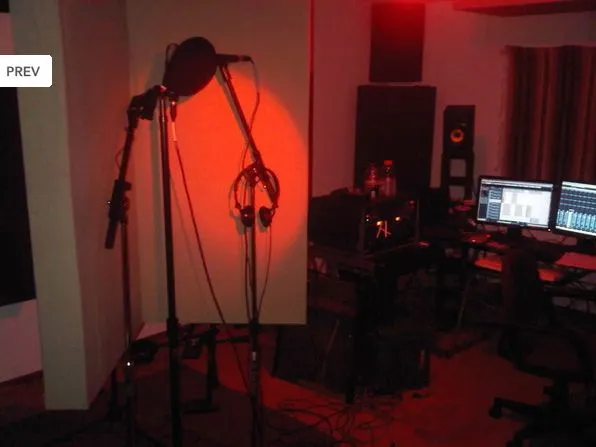

Sounds reasonable. I myself have a bit of a unique setup for recording vocals. My room is a bit larger than yours 13x35x8' high and only 2 full length bass traps behind monitors on vertical walls. 10 4'x2'x4" thick panels spaced on the walls and two on the ceiling above mix position.
This is an old pic but I still use these hanging panels for recording vocals. Seems to work great for me.

Sorry to go off-topic here, but Jimmy you've gave me an idea about my vocals dude...I was thinking of making a reflection filter, but I can take a couple of the Roxul panels down, mount 'em on mic stands, & have a portable "gobo" for my vocals...Thanks dude!!!!:)
That is exactly what I do. I pull two off the wall but have chains and hooks connected to the tops. 4 hooks in the ceiling joists that they hang from.

I built them. This batch was built using drywall corner bead as frames. Super lightweight. Roxul 80 4" slabs. LINK
