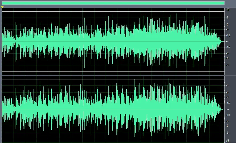

Tracks before Making Real Loud with a brick wall limiter...

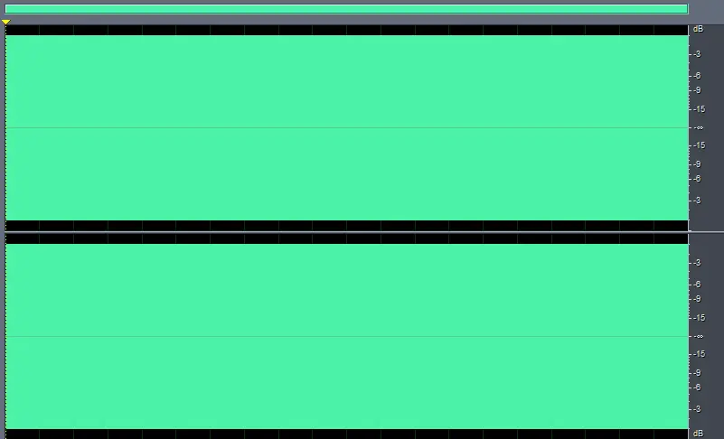

Tracks after Making Real Loud with a brick wall limiter... Such elegant dynamics!
