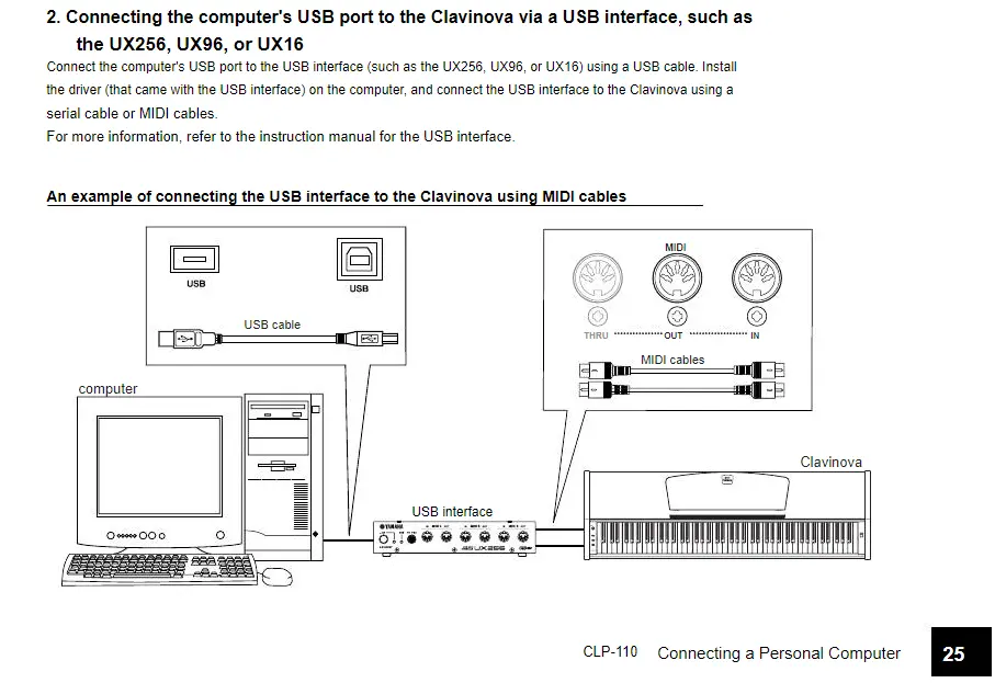

Maybe this will help.

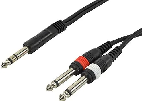

The clavinova headphone output is a regular stereo 1/4" socket. There's two of them - You'd use one.
To record to your computer in stereo you'd want a 1/4" stereo to 2X1/4" mono cable, and you'd connect the pair of mono ends to inputs 1+2 on the focusrite, setting the line/isnt switches to line.
The cable ends look like this.
