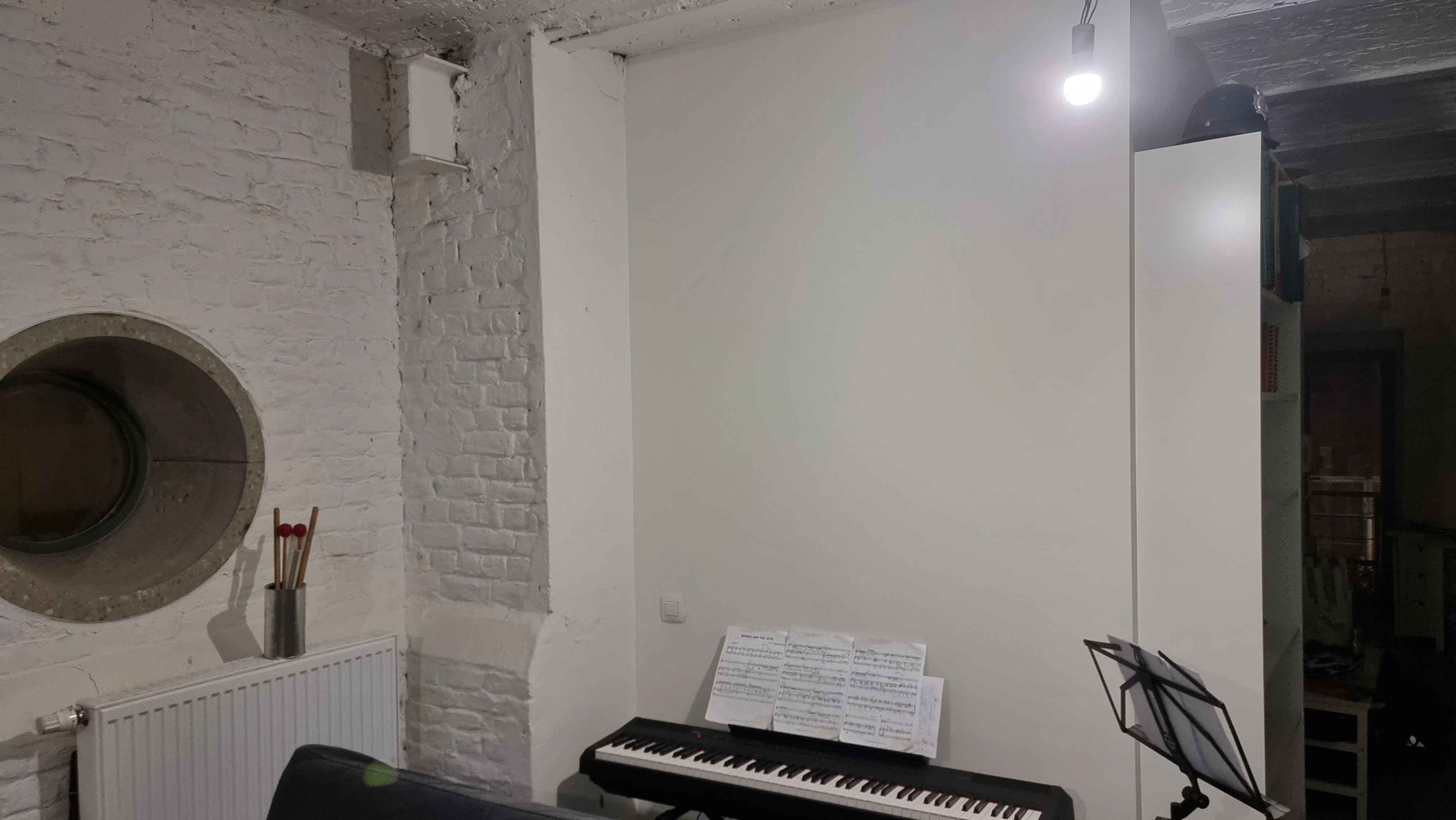

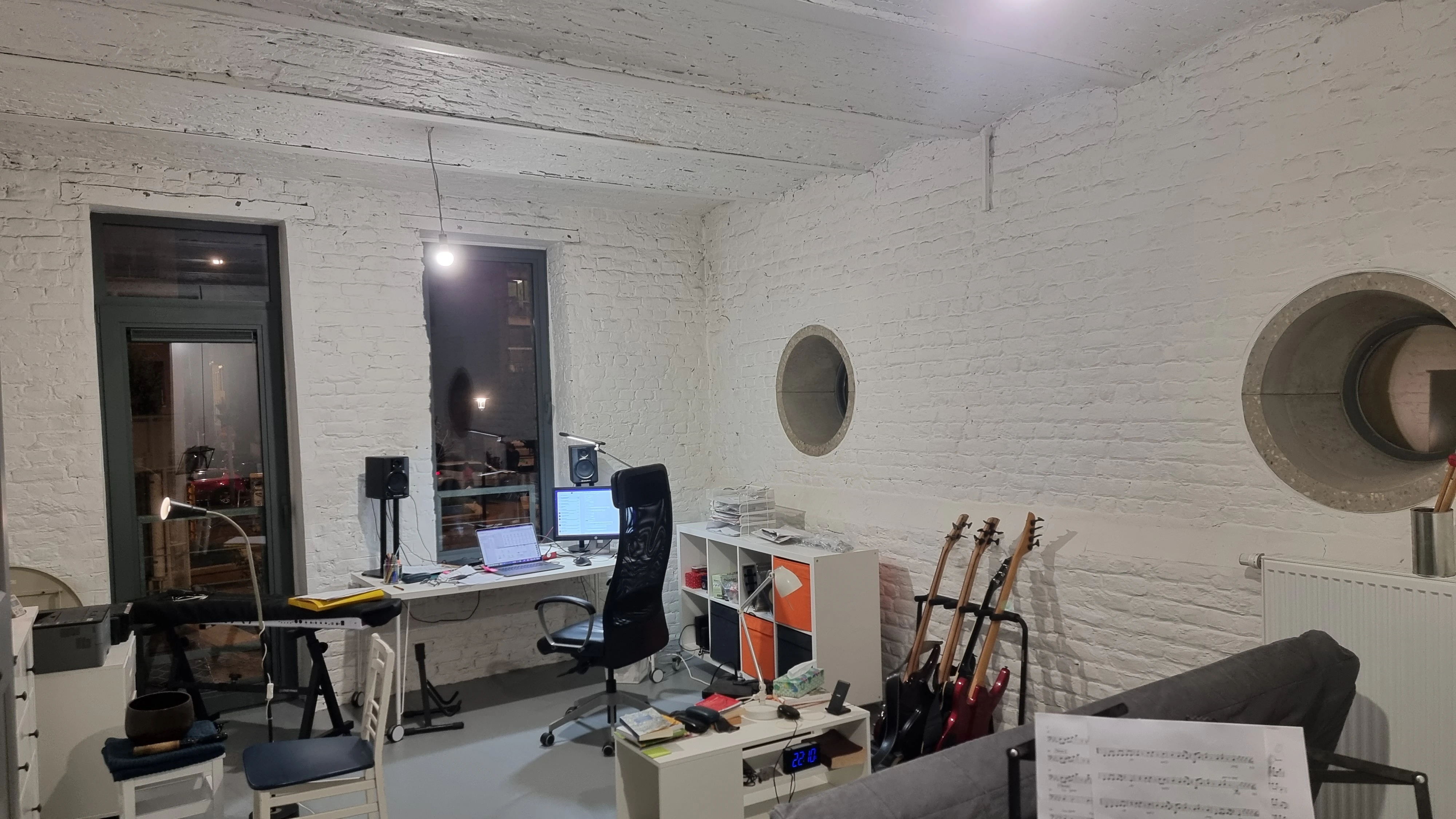

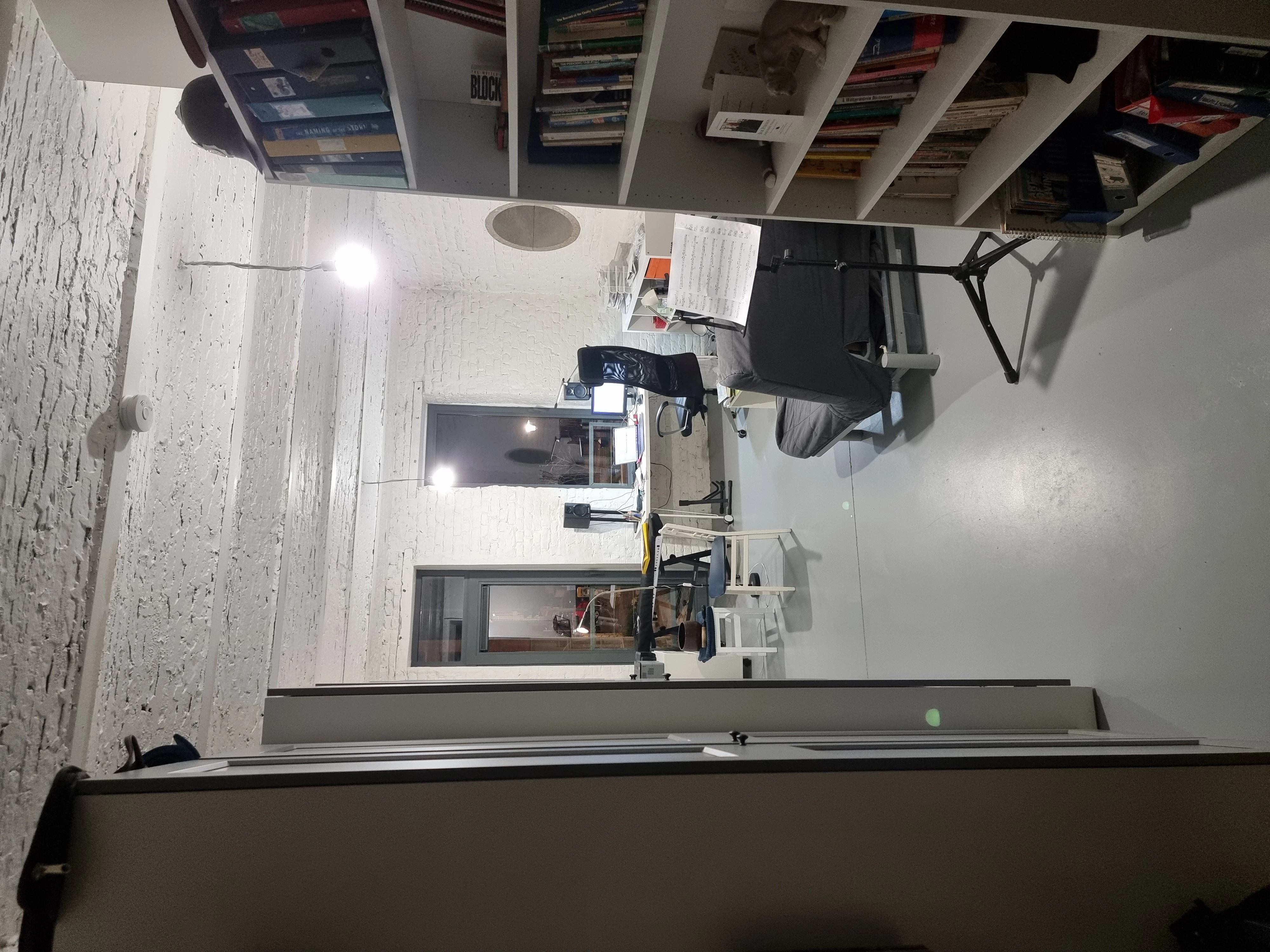

I have just moved into a studio flat in a complex of live-work spaces for artists in a converted brewery. It is very reverberant and, I think, quite challenging to turn into a recording space, especially as I want the space to perform several other functions as well, and as I also don't want to lose the 19th century industrial character of the space. At the moment the space is so reverberant that even listening to music recreationally is a bit uncomfortable. Where I want to get to, if it is possible, is to tame the reverberations enough be able to mix and master in the room using speakers rather than only using headphones.I have put some photos of the space at the end of this post. The first photo is from the entrance area, which is a wide, short corridor. Behind the camera is the kitchen area and in between, to the right of the camera, are the toilet and bathroom .
As you can see from the photos, nearly all the wall is raw brick except for the wall with the digital piano against it, which is hollow. I am hoping to get an acoustic piano to put against that section of wall, but their would be room for some acoustic panels above it.
The ceiling is vaulted brick. I don't think I'll be able to attach anything to the bricks in the ceiling, but I might possibly (although I'm no expert) be able to drill holes in the girders supporting the vaults. That will also depend on whether the landlord would be OK with that; in other words, whether the landlord will consider it equivalent to drilling holes in the walls, which is definitely allowed.
The floor is concrete. I can certainly consider putting a rug on the floor, but I wouldn't want it to prevent me moving furniture around, which I will need to do to make the space work for particular functions. Several pieces of furniture are on castors and can be moved without too much difficulty, but the sofa-bed needs to be slid around a bit, for instance in order to get to the piano, and a rug might make this more difficult.
The wall between the two round windows I want to use as a backdrop for a long-term video project. This means that anything I attach to that wall needs to be easily removable, and the mounts on the wall for those removable objects should not be too obtrusively visible. I have actually been thinking of mounting a large pinboard on that section of wall, if I can find a way to do it that will allow it to be removed and put back in place without too much difficulty. I don't know whether a pinboard would do much to dampen reverberations. The pinboard would be useful to me for developing visual ideas, but if using the space for dedicated acoustic damping would make the space work better for recording and listening, that may be a compromise I will have to make.
I would also like to mount one or two framed posters on the wall, to make the space more homely and personal, but again, if acoustic panels would make the sound of the room easier to work with, that may be another compromise I will have to make.
I haven't yet bought anything to cover the windows, but I think roller blinds are the only option, which I guess won't do much to change the acoustics. Correct me if I'm wrong.

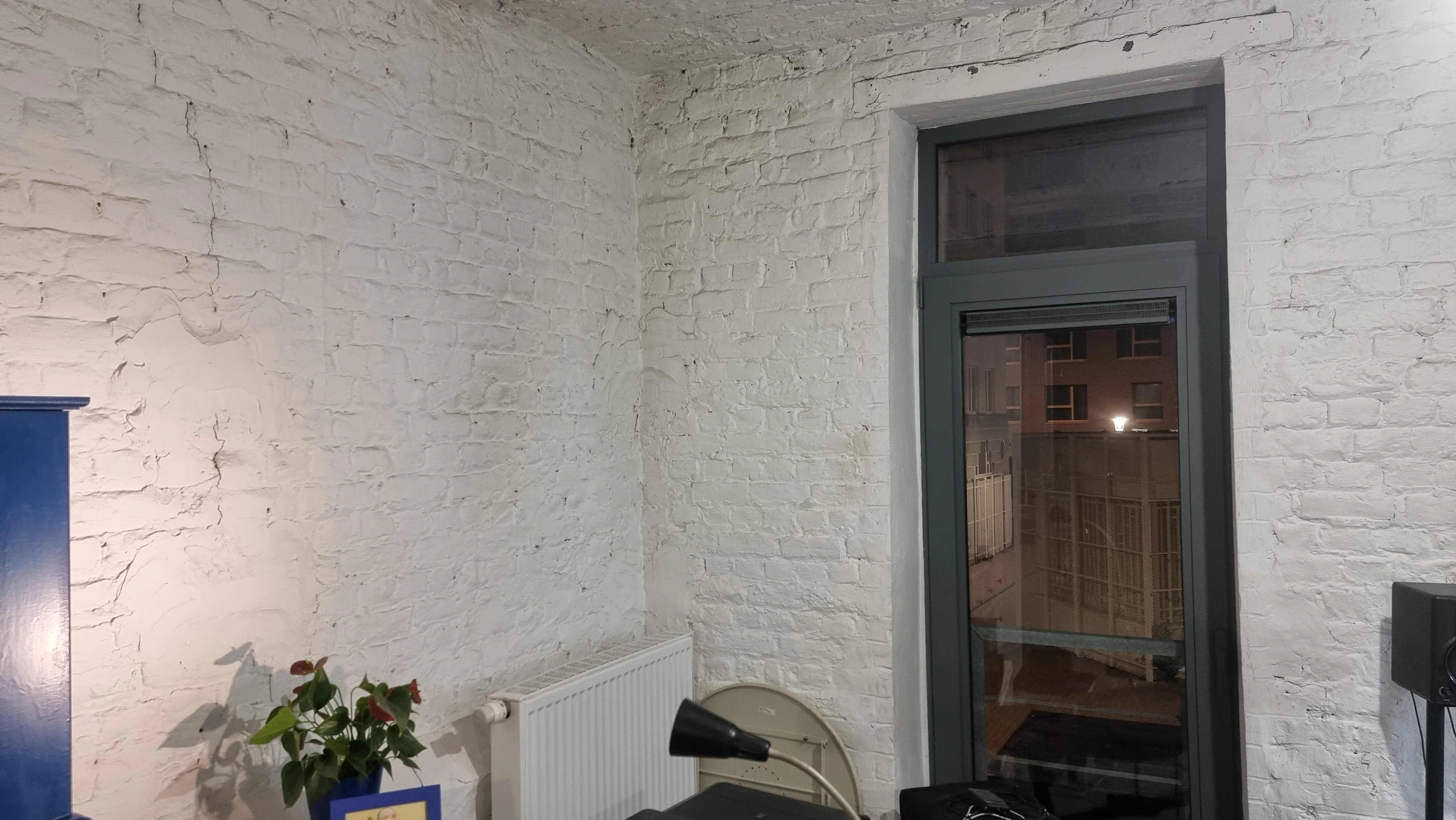

I know that there is a lot of of bass in the resonance of the room, and there is certainly space in the three corners for bass traps. Should I put bass traps in all three corners? If I can get away without putting a bass trap in the corner to the left of the windows, that would mean that there would be space for a picture above the radiator. Perhaps I could put a flatter acoustic panel on the wall to the left of the French door to catch other frequencies?
Another thing that I could possibly do is create a temporary buffer behind me when I am mixing using the speakers (which will be where they are now, on the desk by the window). I could use a duvet for this, suspended from a bar across a pair of stands that are normally used to hang a cloth green screen for video recording. However setting this up and dismantling this stand would be quite time-consuming, so it is not my favourite option if there is an alternative solution.
