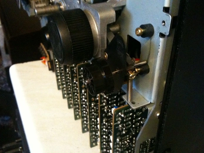

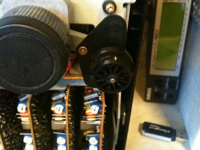

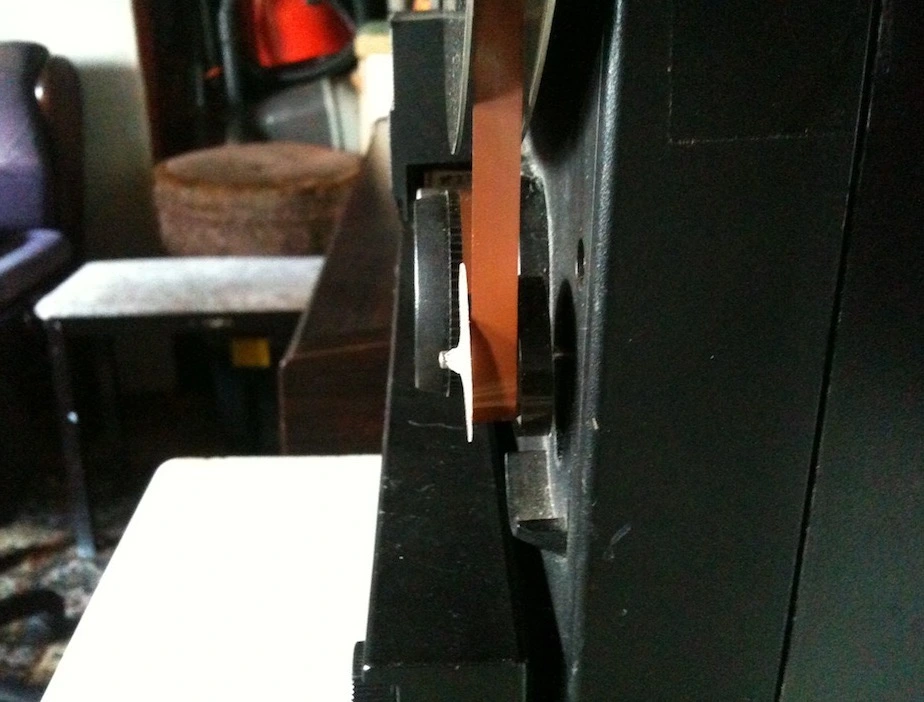

The tension roller caps are missing; I presume they prevent the roller from coming away from the machine?
Anyway, in playback the rollers sit where they're meant to be, more or less.
Fast forward is the same but in rewind the rollers work themselves down the shaft away from the machine.
They won't come off but their natural resting point skews the tape off its path.
Do I just need new shafts/rollers/caps?
The best way I can describe this is that it works but you'd definitely keep an eye on it!
Looks like they're the same as the little cap for the pinch roller.
It's just tight enough to keep everything in check, but it could pop off and be lost handy enough, I guess.
The actual shafts and rollers aren't missing. One of the shafts was bent but I straightened it out pretty well.
PM sent.
Here's a few pics to show what I'm talking about.
Both sides are the same.

the roller on your photo looks very diffrent from what I have on R8,
here's link to photos and close ups showing how to remove the roller:
http://www.mzentertainment.com/pics/fostex_r8/dr_zee_workshop_fostex_r8_project_part_1.jpg
there are two small washers on the shaft one one each side of the roller, those are important to have.

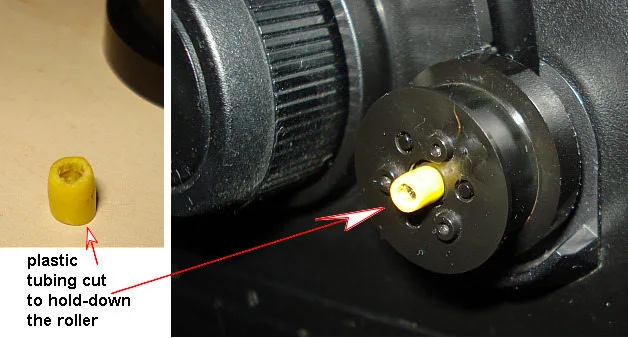

One of my top caps was missing. I fixed it by snugging a small cut of plastic tubing (stripped from a wire) on the shaft. See the attched picture.

uh,
after looking again at your photos now I think that in addition to top caps your rollers are also "missing" a part of them - the top (or say - front) flange. I am not sure if it's 100% the case, hmmmmmmmmmmmm ... looks kinda' strange :drunk::drunk::drunk:
You are correct DR ZEE.
It looks like the missing disc is larger in diameter than the tape path.
This makes sense....

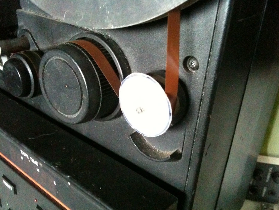

I just fashioned a pair of plastic discs which pop on, hold the rollers in place, and keep the tape from running off the edge.
FFd+RWd a full reel with a few stops and plays in between, and so far it seems tip top.
I'll stick a photo up shortly.

Well, the discs as pictured worked, but they were static which meant the tape could rub against them.
I bored out the hole, glued them to the plastic rollers, and used plastic tubing as Dr ZEE suggested.
It seems to be pretty much perfect now. :)

Sorry - These pics aren't great.
