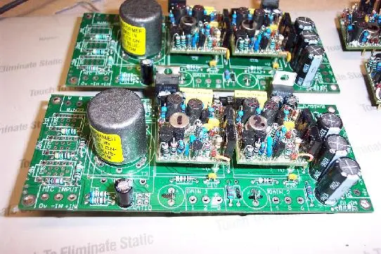

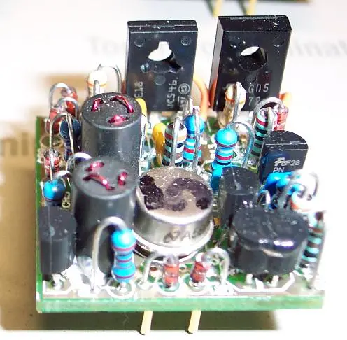

Here are some photos of the 1) breadboarded power supply (+-24 V and 48V) 2) a Jensen 990 Discrete opamp 3) the 2 channels of Jensen twin servo I'm building on a JLM twin servo PCB.
Hopes this helps! :D

I'm building 4 channels of JLM baby animals at the moment, the first two are up and running and they sound pretty fantastic, OEP input xformers and the JLM99V opamp, the other two will have Lundahl xformers and the JLM hybrid opamp. It's a bit more paint by numbers than your first post suggested you were after though.
