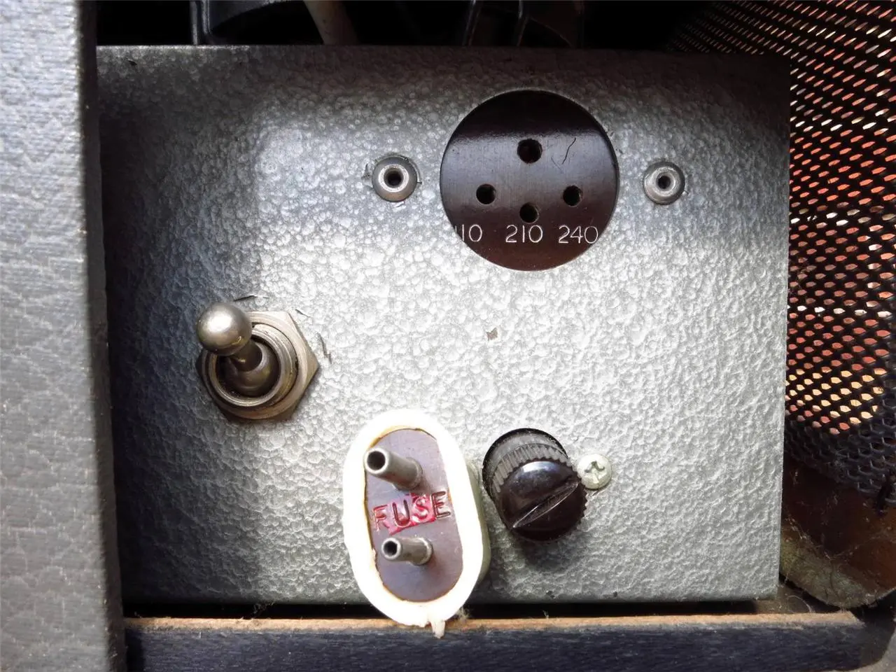

Hi there,
I'm looking for a two-pin 1A fuse that looks like this - can't seem to find one, maybe I don't know the correct name:
Thanks,
Will.
Looks more like a simple jumper to select the local voltage?
Plus, there's a fuse holder just to the right of it in your picture. Maybe it says "fuse" on it as a reminder that you might need a different fuse depending on the voltage selection?
Have the manual, and if so, does it document anything about what I just mentioned?

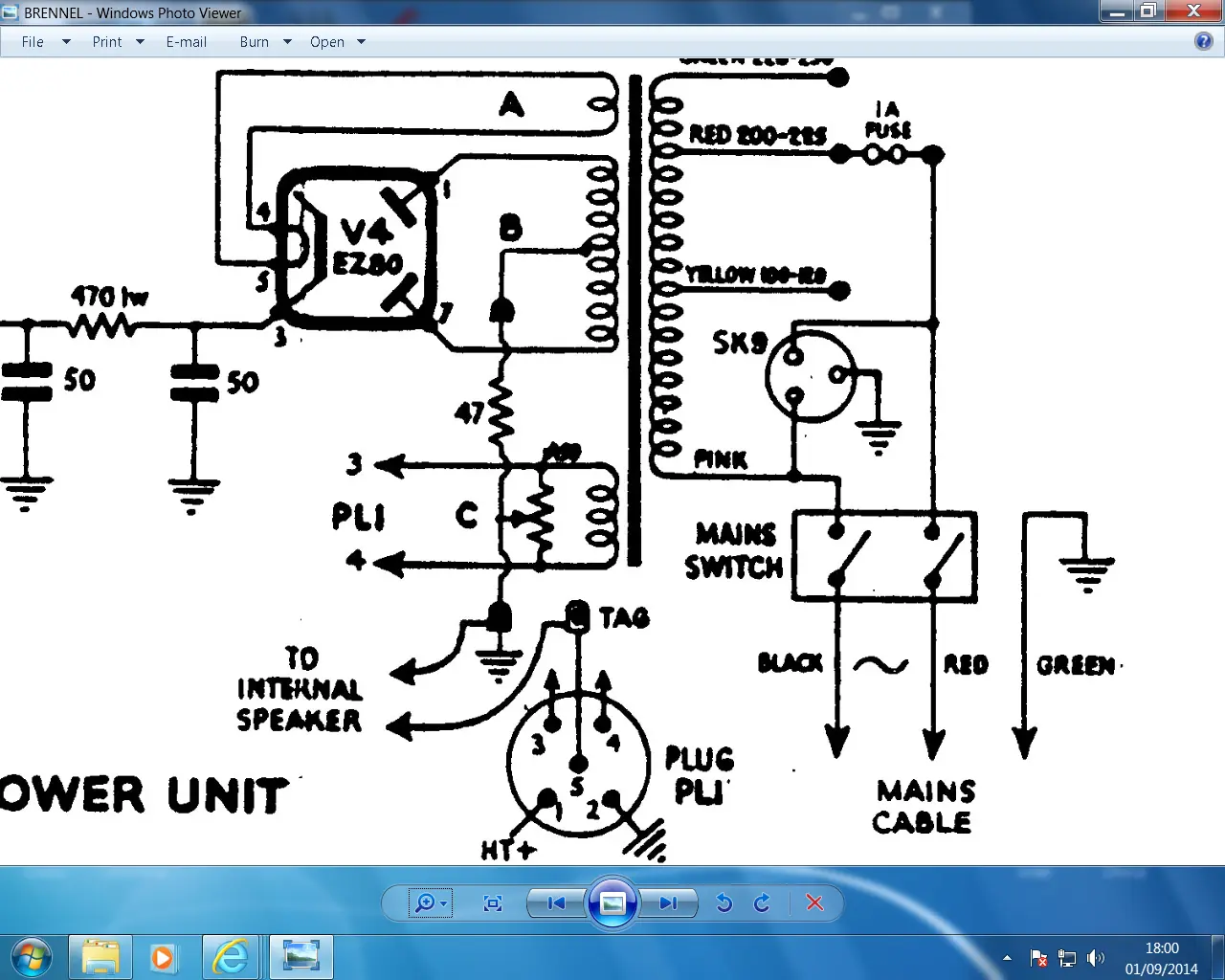

Yes I know what you mean, however the 'fuse holder' seems to be a pot actually, it can go a certain amount both ways but then stops, it isn't a screw. I thought maybe it was the bias control? perhaps this will help it's the exact circuit I'm using (the power unit circuit):
The schematic clarifies it. Thanks.
That is one unusual fuse indeed!
If you can't find an OEM fuse to replace it, all I could suggest is soldering one on externally to the blown one, leaving enough room on the contact poles to still insert it and make contact OR solder a fuse on the backside of that panel connector to get it going again.

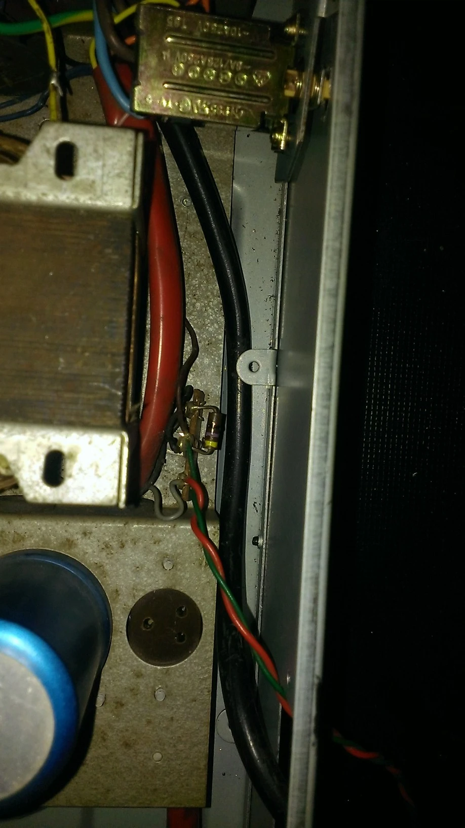

Thanks for confirming! That picture isn't actually mine I just have that power section, its missing the 1A fuse. I'll go buy one and solder it on externally in that case. Its from a Brenell Mk5 Mark II by the way :-) i got a few parts of a broken machine (PSU and preamp section) and am making a standalone amp hopefully.

I have no idea about that one. The only variable resistor on that schematic is for the VU meter, as far as I could tell. Perhaps there are additional diagrams that you're missing which might explain that pot in proper detail as VU calibration pots are normally part of VU meter's physical casing.
Cheers! :)
I disagree - it's just that the circuit is draw a little oddly - I'd expect the fuse shown is the fuse holder in the picture, and the out of the fuse holder goes to the large pin, and the link goes to the transformer taps. There is only one fuse shown, so it has to be a simple link plug.
Cool, I will wire it up and see if all is good. Should really find a little cover for the fuse as well I'm thinking for safety.
does that white rubber looking cover pull off of that jumper? If so you could then replace the fuse?
In addition to the meter calibration pot there is another across what look like might be the filament supply (bottom left of transformer). that would be adjusted for minimum hum.

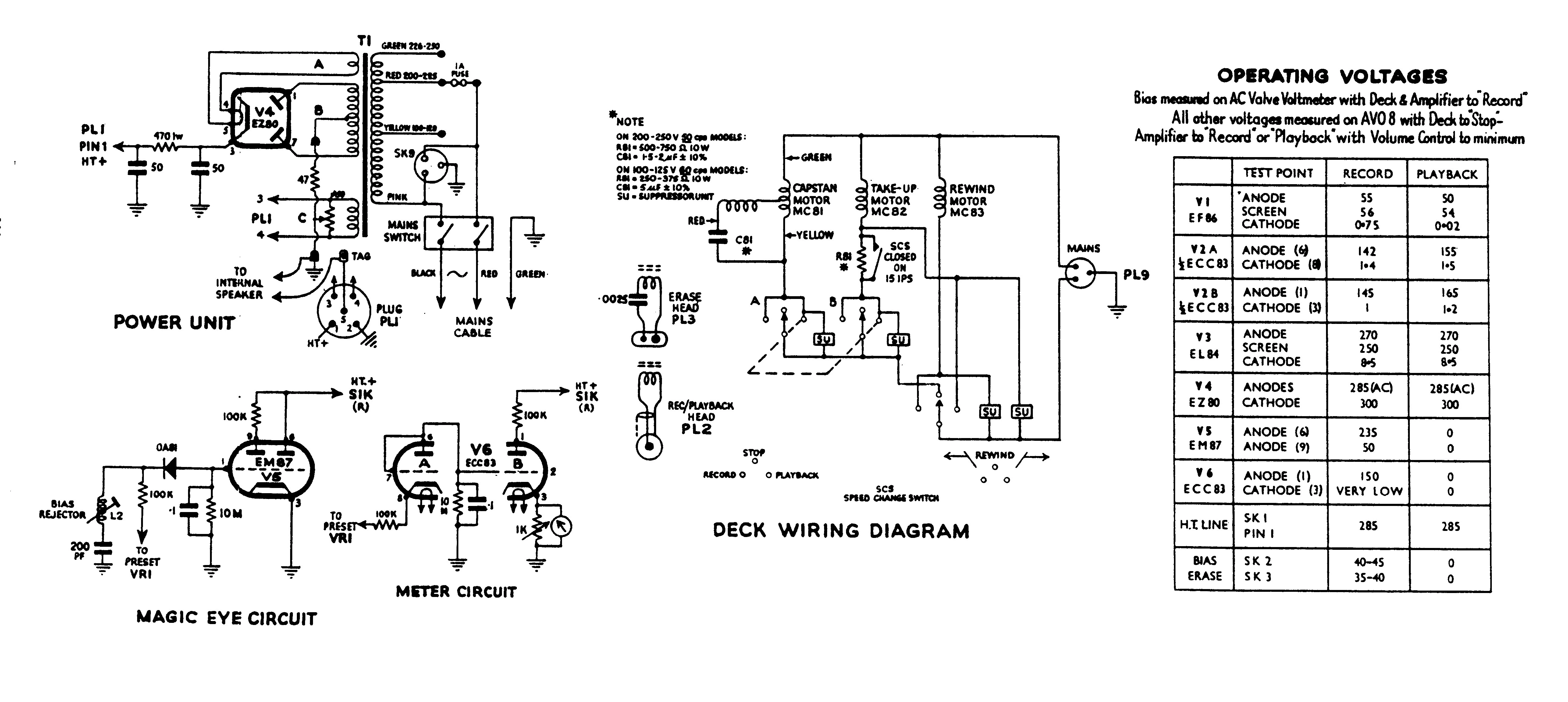

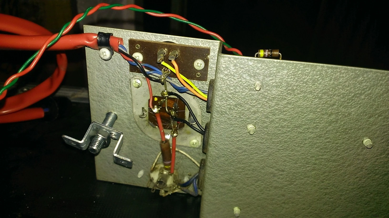

So I finally got round to firing up the Brenell preamp, ran a bass through it and sounded great for about 5 minutes! After that there was a nasty load of smoke and liquid coming from the power supply! It was brown, check the photos below. Pretty sure it came from the big blue capacitor thing, you can see the sticky strands on the underside in one of the pics. Need to get a new one I take it, can't figure out what it's meant to be from the schematic I posted on the last page??
Yeah, if you read through any of the restoration threads here and elsewhere, changing out old electrolytic capacitors is pretty standard for any gear 25 years old or older.
Cheers! :)
Its the two section electrolytic in the "Power section" of your schematic that has shit the bed.
