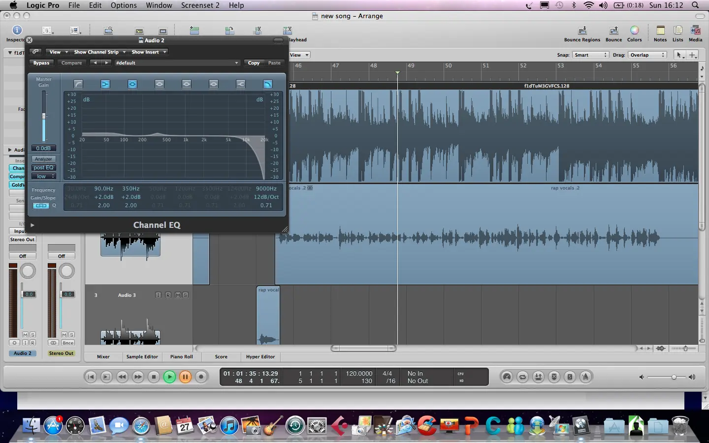

is this right?
is this right?
Look at it dude. Now you're boosting the bass from 100hz down and cutting the highs from 10k up.
That's almost the exact opposite of what I did. :)
There's no right or wrong. Only what sounds good to you, but here's my eq for reference.
www.steenaudio.com/maseq.png
Notice the low cut starts higher, because your last recording seemed bassier to me.
