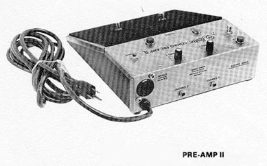

I have a 147. If you're not electronicly hip, you should try to find the Combo Preamp and 6 pin cable that goes with it. It'll make it possible to connect it line level sources.
So there's actually a read-made preamp for it? Wicked... I'll have a look around.

Here's a picture of one (without the 6 pin cable).
