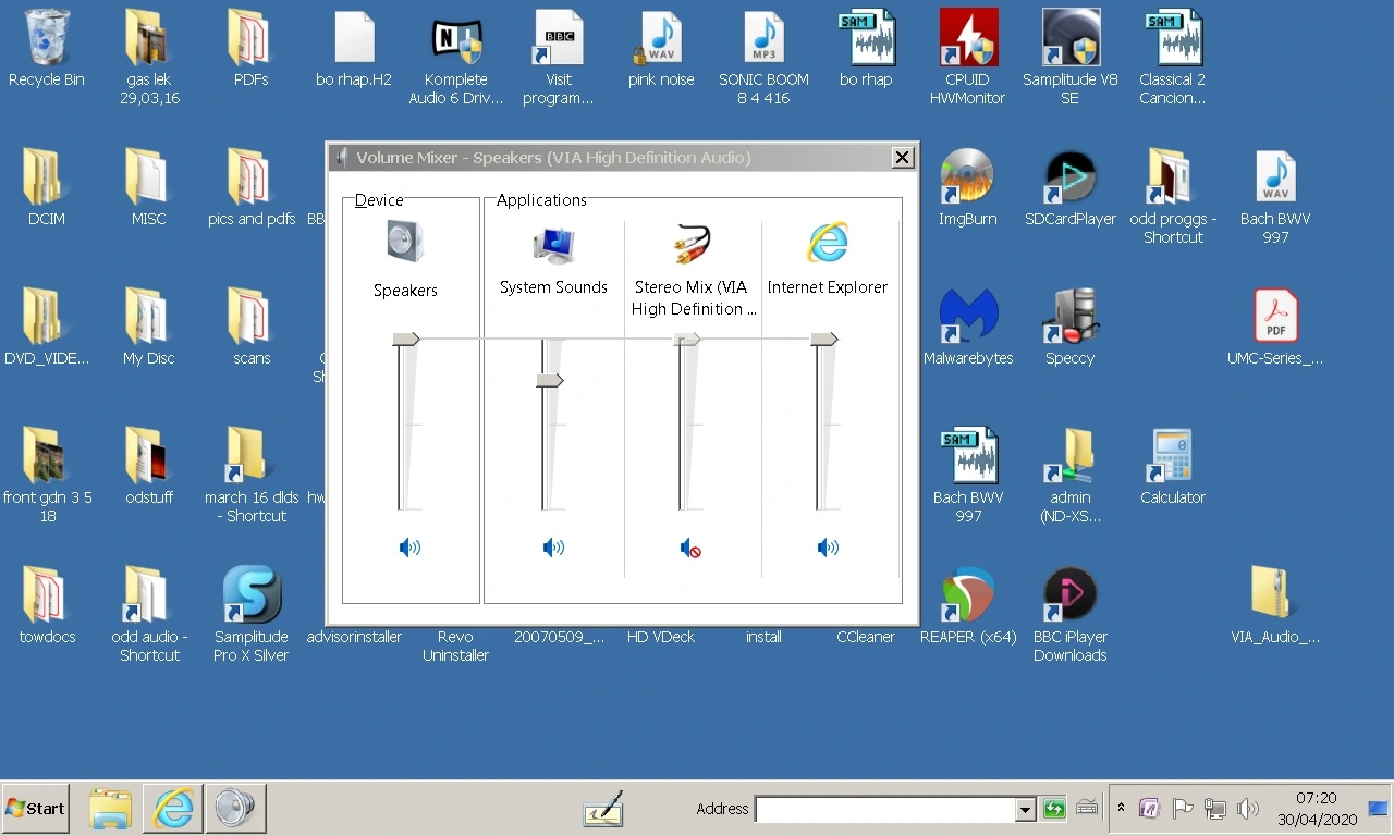

XP! Blimey, might be worth looking in Windows Sounds and Devices to see if there is the equivalent of the Mon Mix shown in the attachment (from W7).
I am presently listening to Radio 3 through my hi fi system and the source is a desktop PC I use in my living room, mainly to host a printer/scanner. I have to have that function defeated or I too get an echo in the sound.
Strictly speaking if you are running ASIO drivers the Windows setting should not matter but, ***t'appen.
