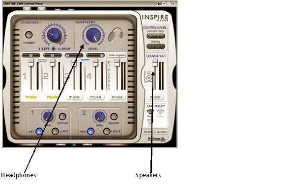

The Presonus comes with a control panel function that is installed when you run the installation program. Open it and you'll find the controls you need to do this. It's covered pretty well in the manual (pg. 17)

Thanks but I think when I turned down the speakers knob, it turned down the headphones as well. Is this possible?

where do you have the headphones plugged in? IIRC, the inspire does let you adjust the headphones-out and the monitors-out separately using the control panel.

The headphones are plugged into the Inspire next to where the monitors are plugged in.
No, not if you have the headphones plugged into the correct outlet. There are 2 mini plug outlets on the back of the Inspire. One is for headphones, the other for monitors. It sure sounds like you have the phones plugged into the Monitors mini out instead of the phone mini out.
