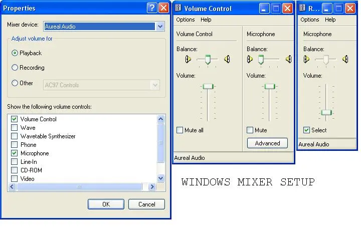

My first problem was the Windows Mixer settings.
a. Right click on Windows Volume icon- select Options
b. Setup Playback- only have Volume Control and Microphone checked
(deselecting AUX removed a large amount of hiss, also may have to go into ADVANCED and select db boost for microphone if you can't hear the mic)
c. Setup Recording- only select Microphone, all others deselected.
**This is for a Microphone only setup. LINE IN may be slightly different.

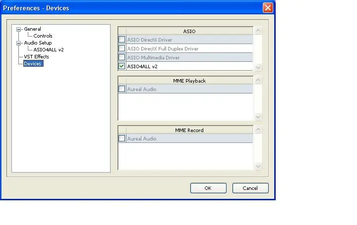

FIX for the Latency
Downloaded the ASIO4ALL.
Then in Kristal- Select only ASIO4ALL. <see jpg>

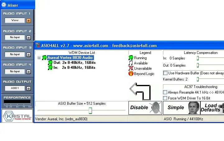

Then Disabling the Game port in Windows/ Hardware/Device Manager. As mentioned in the above article.
Also checking latency settings was done in Kristal Audio Output, as was mentioned in previous post. (didn't need to change anything in the ASIO4ALL settings for my pc).

cool deal man. you have much more patience than i had when i was trying to get Kristal going for the first time. if you have'nt already, you should share your experience at the Kristal forum to help out other frustrated Kristal newbies.
in your asio4all panel, it's showing 512 buffer samples. that is your latency. if i remember correctly, you divide your number of samples by the sample rate your using to figure out your latency in milliseconds.
512 buffer samples / 44.1 khz sample rage = 11.6 milliseconds. that's pretty damn good considering you are using a regular o' pc sound card. :D asio4all rocks when you need it. if you have'nt tried it yet, you may be able to get an even lower latency by adjusting the buffer samples slider in the asio4all panel. i think the lowest stable setting i was able to use was 256 or 384 (it's been a while). low latency is only really needed if you're monitoring the live input. for example, running a guitar direct in and using the kristalizer distortion.
also, don't forget about asio4all if/when you upgrade your sound card. i've read about some people using it instead of the sound card manufacturer's asio driver and getting better results.

I wondered about that. I moved the sliders and recorded a bit..but didn't know what I was doing (terminolgy wasn't understood).
Thanks for the info. I was confused because I was expecting to see the Latency in milliseconds as was mentioned earlier and it wasn't there.
Only this "sample buffer" thing.
So the lower the better on the buffer size because its divided by the sample rate? now it makes more sense.
