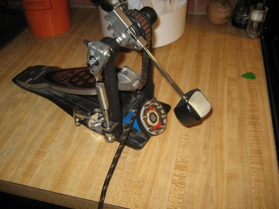

I built a trigger out of a decent used pearl bass drum pedal. I turned the beater around backwards so that it swings toward the foot plate. I mounted a triangular hardwood block from my kid's toybox to the base where the clamp that attaches to the bass drum hoop was. I screwed a rubber foot from an old cassette deck to that and used the piezo from some radio shack buzzer I had in the garage. I used a few varying sized O-rings to position and dampen at and then screwed a piece of thin plexiglass over top of it as a batter head. worked great to trigger my DM5. Much better to me than the rubber pad that came with the kit.

After a year, it quit working. The lead came desoldered from the piezo. I had to tear it all apart and I am replacing the piezo.
What do you use to keep the mechanical shock experienced by a percussion instrument from breaking the solder to the leads? Should the trigger be isolated from the batter "head" and just turn up the sensitivity? I thought that would cause alot of false triggering.
If anyone has made these kind of small, non-drum triggers, I would love some advice for keeping the wire connected for longer than 11 months. I bet it broke after using it 20 times. It was an elegant design, though.
Here is what the contraption looks like.

The painful truth is, the real ones crap out after a while too. I only use them once in a while in the studio, but I have to replace at least one trigger unit a year. And those are the ones that clamp onto the head of a real drum, not ones that get hit directly.
They are just fragile things that get beaten to death eventually. The best advice I could think of is designe it so you can easily replace the piezo.
