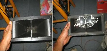

Looks like a horn to me, or is it piezo in a casing? I got some CRC Contact cleaner that I use in my car's electrical, should I try it first?

It looks kinda like two piezo drivers mounted on a horn. I'm not certain though. Do they say anything on them, like 8Ω?
The wires that go to that horn, do they come right from the woofer speaker? If so they are piezos. What I'm getting at is that it would be nice to try the amp without the tweeter. If it's a piezo that's safe, if it's a horn that the amp needs to get a load say of 8Ω from then it would be bad to use the amp without the horn.
The red and black wires go from the board to the horns and the set of black and white wires go from the board to the woofer speaker.
The only thing it says on the horn is Motorolla and made in Mexico...lolz!
It sure sounds like a piezo to me, Motorolla made lots of them. The fact that it comes from the board bothers me though and would make me a little nervous running your amp without them. The fact that no Ω designation is present also seems like piezo-ness.
I'm not going to be the one that says to try your amp without the horn hooked up! I would hook a meter up to the horn and see what the resistance is and substitute a resistor in it's place just to be safe when testing the amp.
If anybody else wants to chime in on this it would be nice. I'm not sure if piezos have any resistance to speak of, whether they present, say a 8Ω load to the amp.
Do you have a multimeter?
I'm not getting anything, just 0
The resistance of the horn is 0 Ω?
If that's the case then I would try the unit without the horn connected. Make sure the wires you unplug from the horn don't touch each other or anything else.
Maybe try one of the horn drivers disconnected at a time - it looked like there were two on it.
