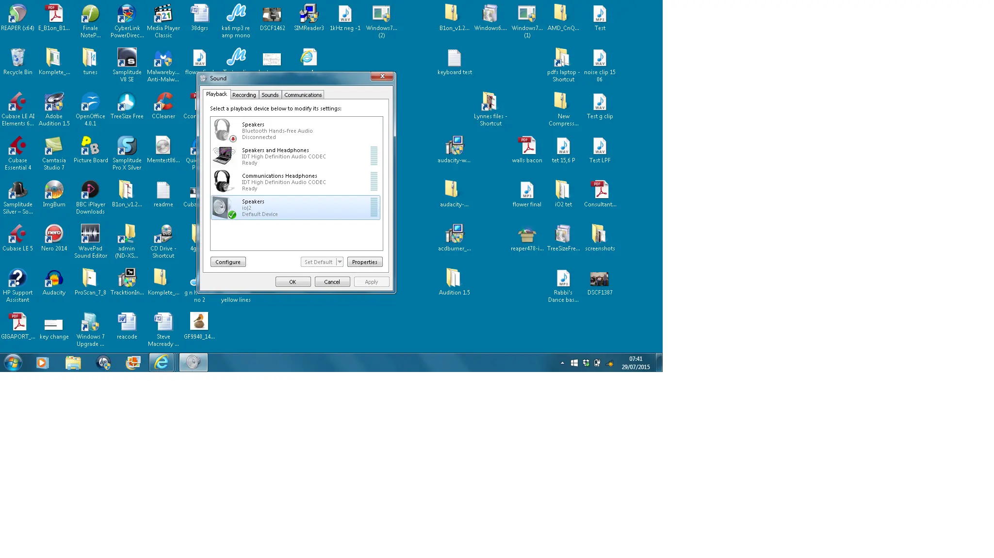

You must set the Solo as the default audio playback device, see attached.
You don't say what your stereo system is but I shall assume it has RCA "phono" inputs? Either "tape" or "aux", maybe "CD"? Whatever, that is where the RCA outputs from the Solo must go, the AI becoming the default, all the time* sound playback system from the computer.
Once you have sounds from the computer, CD, radio, Tooob! You then repeat a similar procedure to get the Solo as the default recording device.
Next step is to go into Windows Sounds and set that to "No Sounds" must do this because those bleeps and bloops will be very loud compared to normal recordings and they can also screw the recording by interrupting the PC processing.
Getting an AI to work is a process and can be a frustrating and protracted one, especially for the noob, stick with it and us, it will soon all become second nature...Promise!
*This is not caste in stone and other arrangements ARE possible but leave us K.I.S.Sir for now?
