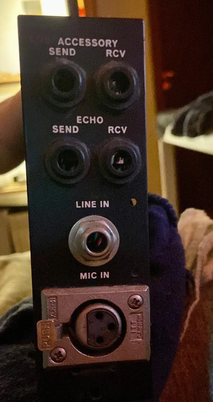

You’ve convinced me — I just went ahead and bought the manual from eBay. You’re right: it’s a rare opportunity and I’ll need proper documentation. Thanks for the push — totally agree that the seller’s price is fair. Regarding the SEND/RCV section, I’ve attached a photo of the channel strip so you can see the layout. I think there is no need for jumpers.

You’ll have to test it out. Looks like somebody possible replaced the RCA jacks with 1/4” jacks. If the jacks do not have normalling contacts that connect the signal conductor at the SEND jack to the signal conductor at the RCV jack when nothing is plugged in, then I suspect you need a jumper cable, but inspect the jacks and see if they are normalling type.
Appreciate the guidance!
Those plastic bodied jacks look suspect to me. Never seen those on any early tascam product. I wonder if they are even properly grounded to the chassis.
Edit. Ps. As @sweetbeats said, unless they are normaled, you need jumpers.

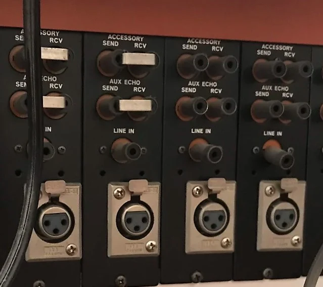

It's highly likely that the jacks were changed. Looking at an old Model 10 listed on Reverb from a year back, you can clearly see the RCA jacks and the jumpers that Tascam often used. You only needed to connect the signal lines since the grounds would already be connected.
If I'm not mistaken, don't the send/receives need to be jumped for the signal path to be complete? Otherwise there's no reason for Tascam to supply the jumpers. If that's the case, then either you need to make jumpers or the jacks need to be normalling to complete the signal path, as Sweetbeats suggested. A simple meter reading of the two tip connections will answer the question as to if they are connected when empty, or if you see a wire going between the send and receive jacks.
It should be obvious.
A short 1/4 inch patch cable will tell the tale. Patch it in, and if it passes signal you need jumpers.

If you put a cable (a simple guitar cord would work) between the send and receive and lost signal the something isn't right. The only way to know is to look at the jacks themselves and check continuity first from the various points.
Normalling jacks have a contact that connects the signal line when no plug is present. On the Send, if you insert a plug, it lifts that contact, and allows the signal to go out the tip of the plug, which would then go to an external unit. On the flip side, the return would insert the signal back from the tip. The sleeve shouldn't be needed as the grounds should all be tied together, but it doesn't hurt anything if the ground is attached to the sleeve.
