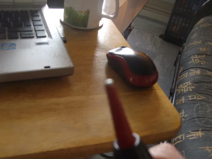

As you can see, the paint has worn away from the tip, Can I use as is, or should I wrap some tape (which kind?) around the head?
Supposedly you can destroy the heads by directly touching them with the demagnetiser. I don't know if that's actually true, but if it were me, I'd definitely put some kind of insulation on it so I didn't end up finding out empirically.
What should I use though? Any suggestions based on experience welcome.
Well - difficult to see, but is it alloy, or plastic? The nicest looking solution is to give it a quick spray with some paint. As you never touch the heads front face with anything hard (metal or not) it won't impact on how well it works at all. The thing to remember about demagnetisers is that all they do is magnetise the heads with one polarity, then the other, 50 or 60 times a second. The key to successful demagnetisation is to decrease the field slow enough that you don't remove it too quick, which would leave the heads polarised. I've personally never destroyed a head with magnetism - but I think the legend comes from what happens if you do touch the head accidentally - you get a loud vibrating 50 or 60Hz buzz, which can physically damage the perfectly smooth surface by a few hundred micro-collisions. I had a friend once who used to collect used clarinet reeds, split them down the middle and he'd place one float on the head gap where the reed was thinnest. He then touched that with the tip of the demagnetiser, and slowly removed it. As close as he could get, bar the really thin bit of the reed - and the wood stopped the surface being damaged.

If you are not using the TEAC E-3, be certain that your degausser has either a plastic tip or plastic tape covering the tip [the tip of mine. where the paint has worn off, is a metallic silver colour, so unlikely to be plastic]. Make sure no metal ever touches the tape heads as it will scar them beyond repair
So, the question is. Will ordinary Sellotape® suffice or do I need to get insulation tape?

You seem to be making this a bit harder than it need be. Insulation tape, sellotape, a lump of blu-tac - the idea is simply to stop you scratching it. You could get some of that latex like stuff you drop screwdrivers in to insulate them. Almost anything will do the trick, performance wise - it's just how they work. I'd watch tape though - how many times have you seen the sticky mess when it gets a bit warm - and you leave this on the heads if you are not careful. You must be able to cobble something up - there is a plastic spray available from amazon UK https://www.amazon.co.uk/Plasti-Dip-Multi-Purpose-Rubber-Coating/dp/B0006SU3QW

It's not about "insulation" as in the heads will be electromagnetically damaged by the exposed metal tip...it's about physical damage by the exposed metal tip, since it is actually vibrating and could scrape the heads if you touch them.
So...anything that prevents metal on metal contact will do.

Electrical tape? It's just to stop damaging the heads with the metal tip.
