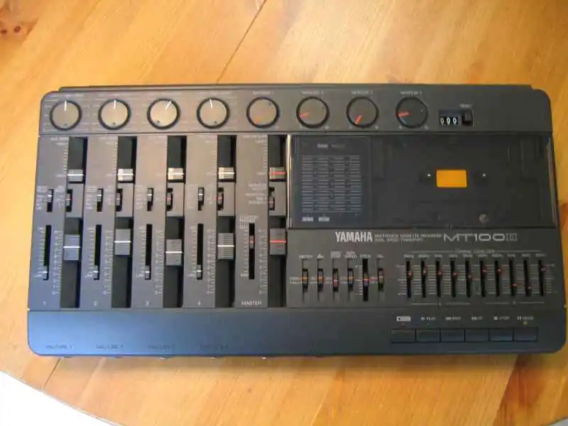

Yamaha MT-100-II
1) Always use High Bias/Type II (Chrome) tapes.
2) Always leave the dbx noise reduction ON.
3) Always use the High Speed setting.....................;)

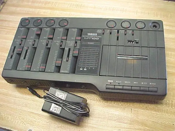

Yamaha MT-100

Hey, that first picture is the exact unit I got back in 1990, when I was 13 years old, wow takes me back!
Had alot of fun with that unit.

Yeah, the MT100II is a nicer unit than the MT100(std),... (has somewhat better features). I couldn't find any difference between the MT100II and the MT120, (based on the picture, above).
