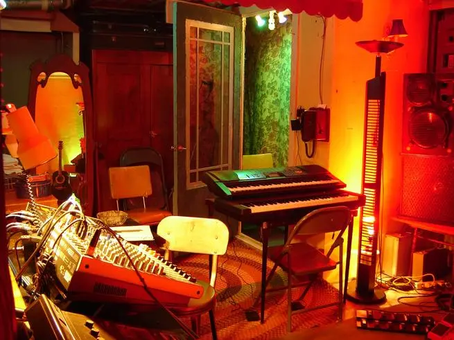

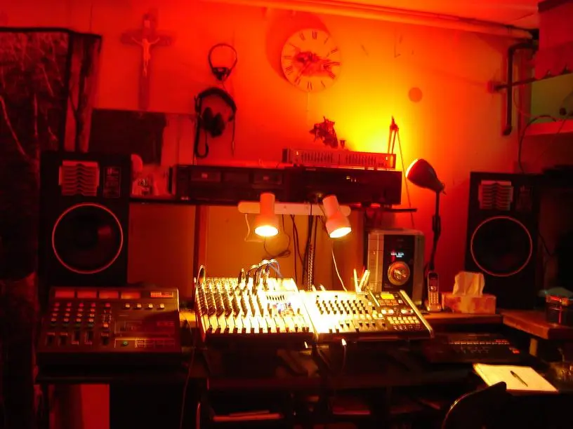

I've just recently started to get into recording after over 30 years of playing and performing. I've had a tascam 144 cassette recorder for many years and used it for little stuff, but now have a tascam DP-02 and Behringer 1222 12 channel board. My gear is a mixture of new and old and a lot of home made stuff. Going from the 4 track tape to 8 track digital is interesting. I'm used to the tape. I worked in a couple of old-tech studios years ago and am trying to shed a little of the "dinosaur" that I learned from those days. I only record for myself and friends who try their hand at writing. It's just for fun and no one expects air play quality, but surprisingly, I can turn out a pretty good sounding product. As time goes and I get more experience and advice from all you guys, I expect to get better yet. I'm not too computer savvy, which is why I bought the DP-02 rather than a computer and program. I'm going to try to post a few pictures of my studio and gear, but I'm not sure how to do that here. So.....have patience with me as I learn what you already know.

LOVE your mains speakers! Back in the early 80s I was trying out some options for alternate monitoring and ended up with a pair of JVCs that looked something like those...
Post dimensions of your room (H, W, D) and we'll suggest placement and treatment of your space. ok?

Thanks. I'll get on that. The speakers are Vision Acoustic and I picked them up at a Goodwill Thrift store for $40.00. I've actually replaced them with some Wharfdale S200 speakers with 8 inch speakers and placed the Vision's on the other wall for full room sound. I'm still playing with things. The big Visions are too large to mix with. I live in a town house and I need advice on soundproofing the concrete walls that separate me from my neighbours as well as lending acoustic properties for the space. My isolation room is small and I'm thinking of clearing out the shelves behind the curtain to expand it a little. Not sure yet.

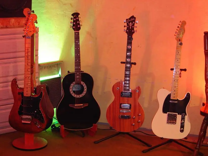

Nice Hagstrom!
Thanks. It's a really nice guitar. I picked it up in a pawn shop about 20 years ago for $100.00. I did some research and found out it was made is 1982 and was one of the last 129 made in Sweden before they went overseas. I think this one was #87 in that line. Weighs a ton.

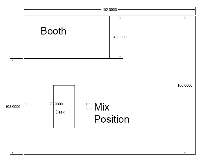

Try this setup... Is the drawing below correct? If not please mark it up and re-post.
Trap every corner you can, treat side wall and ceiling reflection points. Get my First Reflection Calculator here to help with panel placements.
Some great info on setting up your room at the Realtraps and GIK sites.
Cheers,
John

It's 13 ft. X16 ft. X 7 1/2 ft (h). I have a vocal booth in one corner that is 8 ft. X 4 ft X 7 1/2. Two walls are concrete and the ceiling is acoustic tile. The ceiling tiles are stapled to the floor joists and there is no insulation or any kind of sound proofing up there. They are 2X10 wood joists and just empty space.
Ray,
I recommend that you pull down the tiles and fill between the joists with fluffy (standard attic blanket) insulation. Then cover the ceiling with fabric (staple) like burlap. Cover the fabric edges and staples with wood lath finished in your favorite way and you will have a nicely trapped ceiling. This will begin to tighten up your sound considerably.
